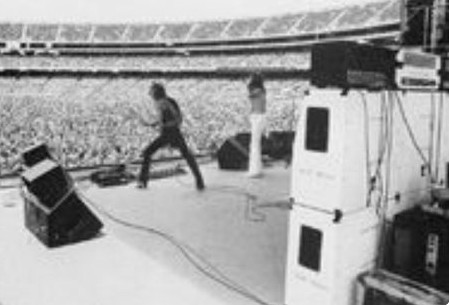

The Flying Dutchman wrote:
And from the many pics we have you can tell he did not use his white Marshall amp that much. Probably because of 'After Hours' this amp became some kind of famous and they used it as a template for the 1959RR but even there Randy didn't use it.
Pat this is a photo of the back of his cabs at DOTG i do have another photo showing the various leads his white head is patched up to his bottom left hole in his 4 holer port on the front. I've seen a good close up pic of that but i'm f*cked if i can find it...seeing the power leads and the criss crossing of where the leads are going is a bit of a cross over from amp to what 4x12 he is patched into...The speaker leads look like they are coming across the top of the cabs from left to right..coming down the stack on the right... (Looking at the cabs from the front.)
Nice photos, both I seen before. The amps you see there were daisy chained together from the right to left (from audience view). Too bad these DOTG pics don't show all there is behind the stacks. I suspect the Marshalls you see there were only used as poweramps to amplify the sound that was already created before. (like EVH did) At that time Randy had 4 Marshalls. Question is were is the fourth Marshall?
Read more about daisy chained Marshalls here: http://www.ultimaterhoads.com/viewtopic.php?t=2752&highlight=handwired
