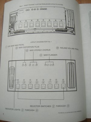

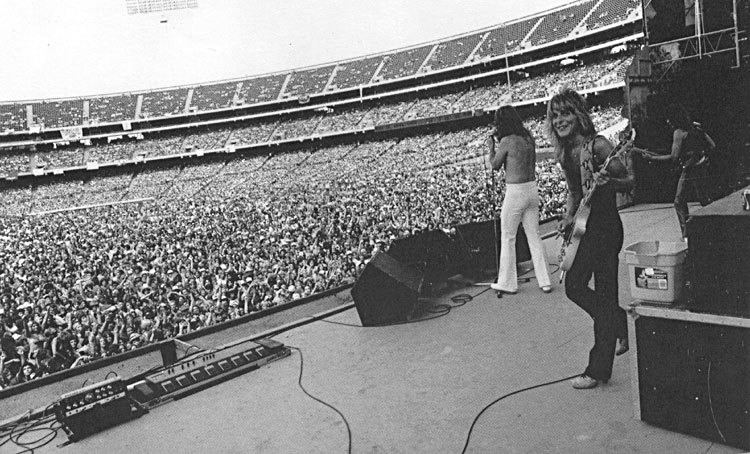

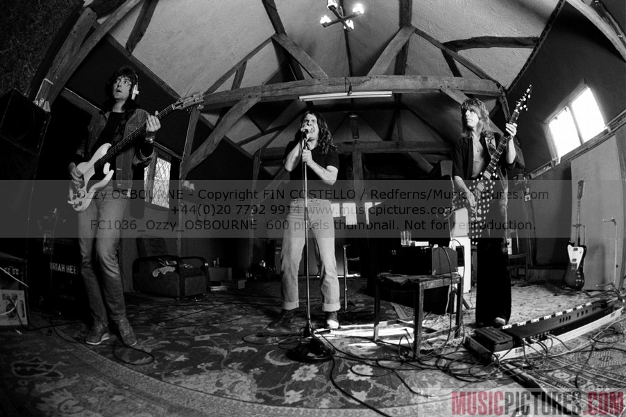

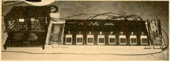

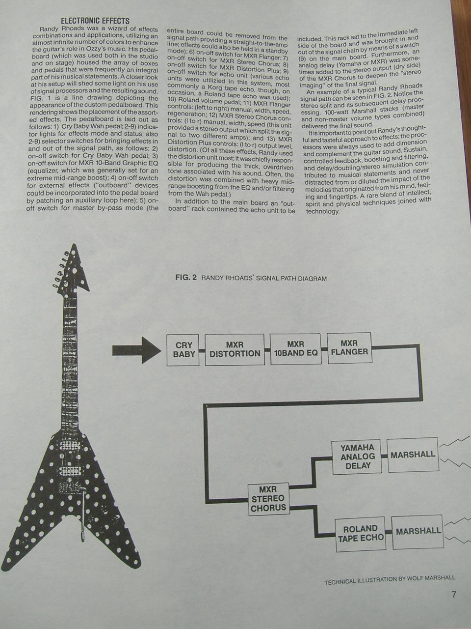

i pmed u a bunch of pics of his chain
the wah after the distortion is too much effect, and drains out everything else. generally wah is before.

guitar->wah->d+->eq->flang->chorus->space echo->delay->volume
first wah always before, it drains out your other pedals, delay has to really be last... all the effect have to really be after distortion and after wah. and the volume must be last because if it isnt it controls the output of the pedals. like lets say you put it first your not only lowering you volume your lowering your distortion and effects.

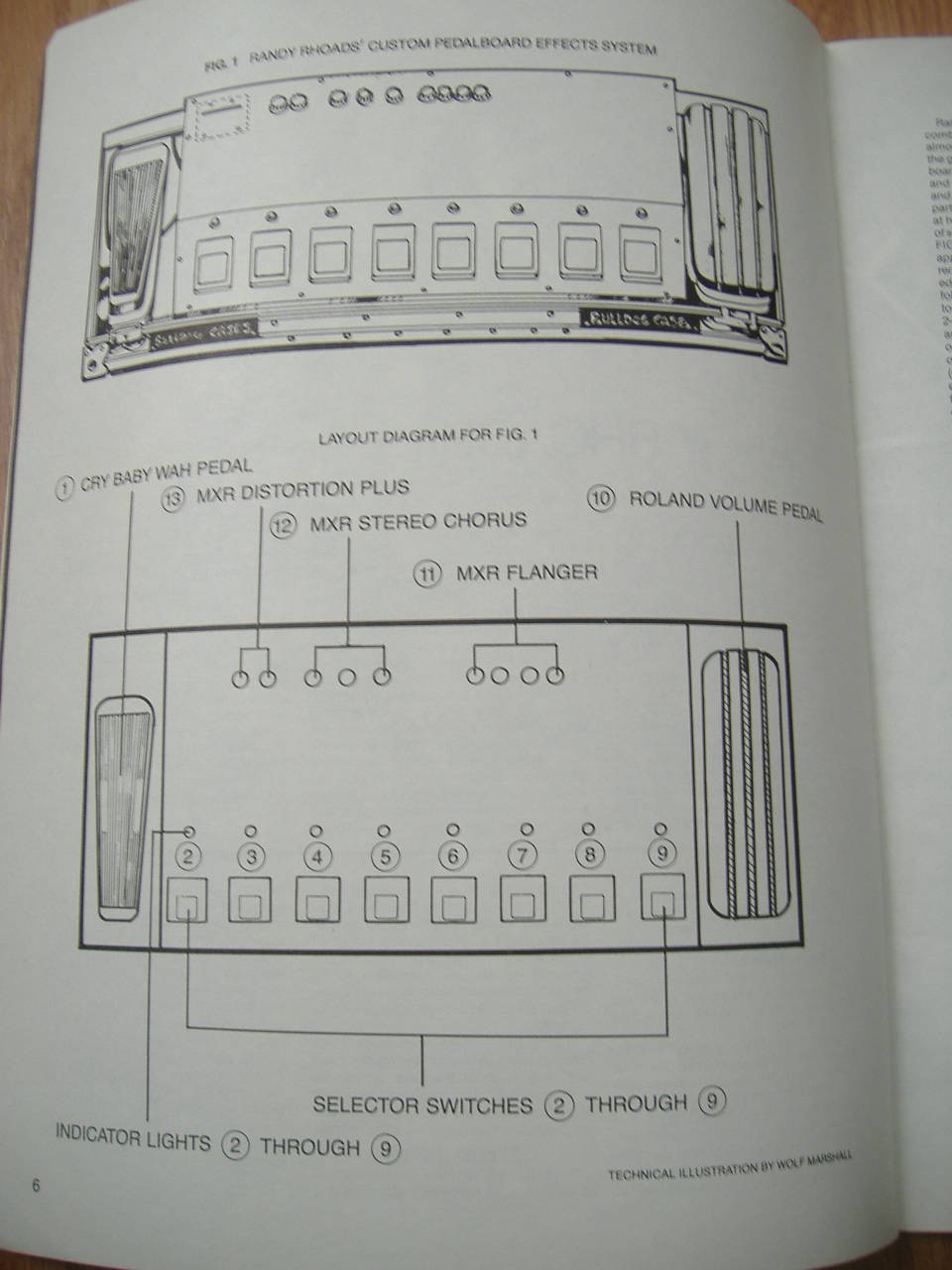

Re: Randys pedals from guitar to amp
i have a great pic clearly showing him, his guitar plugging into the volume pedal last but its .bmp and wont work...
here have randys favorite pic, you can clearly see his guitar going into his volumepedal on his pedalboard.
dude u just proved me right i said it was plugged into the volume first guitar>volume>echo unit>distortion plus>stereo chorus>flanger>delay unit>ten band eq>wah>marshall lolwareagle wrote:you can clearly see his guitar going into his volumepedal on his pedalboard.
true i didnt mean to say that 0.0 i acctually just realized going through pics he just plugs into an 'input' and 'output' on his board. not directly to the effects.
