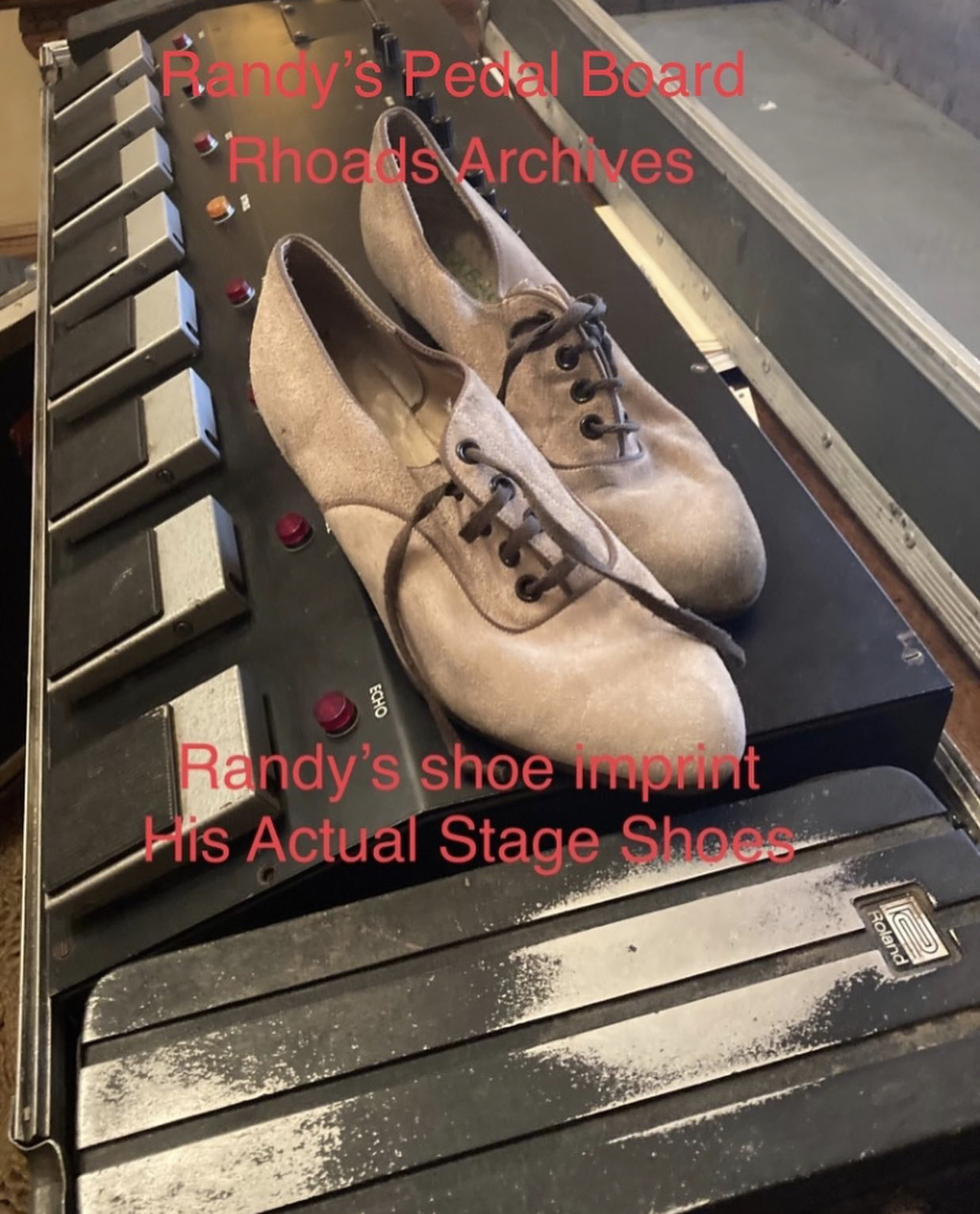

That BIG Roland Volume pedal is Epic!Shockwave wrote: ↑Wed Jul 21, 2021 3:43 pm Should be a good opportunity to finally take some
decent pictures of Randy’s pedalboard. It will be on display along with the white Concorde at the RNR HOF for 1 year starting this fall.
It’s about a 10 hour drive from the Boston area so I think I am going to make a trip out there late in the year or in the spring. Just in case the exhibit is a little too far away I will bring a few gadgets so all sides except the back (if not standing vertical) will get photographed no matter what.
I was gonna ask what RNR HOF is, but I figured it out (Rock aNd Roll Hall Of Fame)!
That's cool, because if memory serves me, is in Ohio and like 4 hours from me!!! I'll search for it also and as this posting was 2 months old...maybe it's already on display or soon?!?? I will be taking a long ride or flight to take Hi-Res photos and besides the back I'm curious about, see if there is any screws on top indicating how Pete may have mounted things and if the pedals were directly mounted?!?

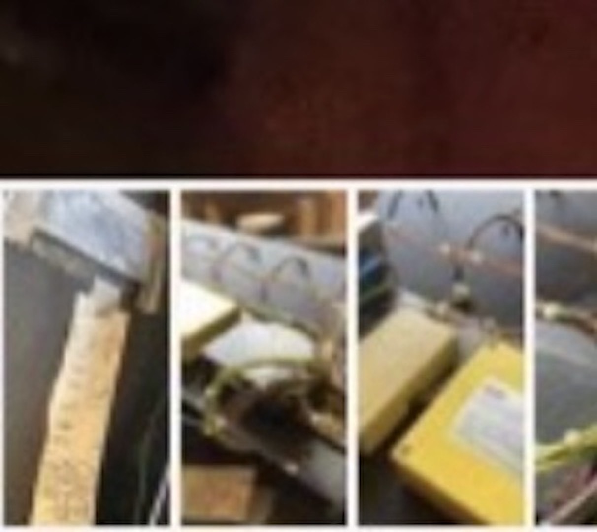

Kathy posted something today and I noticed down at the bottom were these tiny thumbnails in her photo roll that looked like it could be of Randy's pedalboard. So I took a screenshot and zoomed in and I would say its definitely photos of the inside of his pedalboard. The photos in general were taken within a couple days of them shipping his white Jackson and pedalboard off to the RNR-HOF (July 8th) So I imagine she took pics of everything inside and out for documentation sake.
Thumbnails left to right
1. Not sure what that is as there isn't much to go on.
2. His stereo chorus is to the far left and his flanger is to the right. It matches arrangement from top photos of the board, reversed of course since we are looking from the bottom. You can see the patch cables running from the pedal area to each pedal on the board.
3. The MXR Distortion is on the left with the MXR Stereo Chorus to the right. Notice the screw holes on the corners of the stereo chorus. It's definitely 3 knob MXR chorus as I have one myself. You can also see were the patch cable comes out of the pedal and into the lamp indicator.
4. Cut off and can't tell what it is, but looks to be part of the wiring harness.
There were about 15 thumbnails of the Jackons guitar that took up most of the screenshot. The last 4 thumbnails before it got cut off was what's below. She probably has tons of photos of the inside of the board!
I am surprised the original housings of the pedals were used. I figured Pete would’ve taken the guts out, nope. Looks like he just removed the knobs and fed the pot post through the top of the board then used the nut for each pot post to secure the pedal to the board. In general the wiring looks to be an absolute mess. No wonder why he had so many problems.
I asked her about the thumbnail pics and hopefully she replies! If she seems willing and ok I'll ask if she can release a few pics as it would mean the world to a lot of us to actually see the inside of the board.

Very Cool, thanks!
Yes, the pics since Thumbnails are in very low resolution, but appears to be photos of what may be the inside of his pedalboard, especially if obtained from Kathy.
Yes, looks like the pedals if this is Randy's board are indeed mounted directly to the board from the underside and how I did it. Originally, I likewise pulled the board out and just mounted the PCBs to the bottom, but then said, no, as the grounded enclosure can help with RF, so changed gears and remounted back into their original enclosures and put into the pedalboard.
The individuals pedals are not latching, but momentaries and used to trigger some sort of looper. The pedals would be on all of the time and looper engage or disengage the pedals into the corresponding loop and likewise trigger the lamps on and off. What we don't know is what he used, some sort of flip-flop circuit or?!?? It doesn't matter reproducing it, just that a looper momentarilary triggered would be needed.
When seen in person, will be able to see if any screws thru the top needed to secure the pedals. They could be secured with just the pots, but that's not the good way to do it and should be secured thru the 4 screws. The issue is that the threads are on the bottom of the pedal, not top, soo I had to drill thru the pedal top side in the same location and tap the holes. Yeah, a lot of fabrication goes into making the pedalboard and why Randy paid so much (2,000 pounds) back in the 70s and if I was going to sell mine with all original 1977-1980 pedals, all of the labor, custom board enclosure and road case....I would probably have to ask $10k for it!! I'm not sure, I'll have to check if the pot shafts are long enough to go thru the pedals and then thru the pedlaboard! If not, the posts would have to be replaced with longer-threaded ones with the same values and style.
