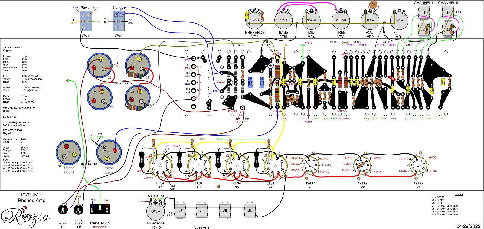

I also was able to purchase again, an all original 1979 100w JMP, just like Randys! I used one of the 4 speaker outputs for a post Tone Stack traditional master to allow the preamp to breakup while limiting the signal to the output section, or turning it up to max! I installed the MOD Marshall did at the factory for him thanks again to Kathy and the family for the gutshot. Instead of having it hard-installed like they dad for Randy, I replaced the VOL II potentiometer from the 1M-A to a 1M-A with a push-pull switch on it, then wired it, so in, it's an unmodded JMP, but pulled, engages the mod and cascading the normal channel into the lead channel!! What the guys at Marshall did was just move ONE resistor (which Danny Thomas from Marshall confirmed when revering the amp for the tribute and someone asked if anything was out of the ordinary and he said one resistor was and you can see it in the gutshot photo)! Both MODs I made, as Randy's are reversible to turn back to stock for resale reasons if need be).
I'll have to see if there is a separate thread on the amp, but what's interesting is that the mod is done for extra gain and you'd think it would only effect the one channel as cascading them, but both channels actually increase in gain! I'll have to make some clips of that also and since I have on an on/off switch.

Spent some time with the amp today. Amazingly, Marshall must have ran out of 820 ohm resistors, as mine had a 1k in it, which in itself is uncommon to Marshall, but ran out and grab the next closest value. Issue is that there is about a 22% difference with this one component!! So, I corrected and still made reversible, by just adding a 4.7k resistor in parallel which makes the overall resistance 823 ohm...PERFECT!!
I spent sometime with it but NEED to make a video for everyone to see and each channel and with the potentiometer pushed in and pulled on each channel. I also added the D+ and EQ settings available and although the "Tribute" amp you plug into the CHANNEL II input, I can honestly say from hearing the amp, Randy I believe used Channel I and as others suggested and from live photos. The reason I thought not was the signal running from Normal to Bright channel, but I can report back that is not the case and with the MOD applied exactly like Randy's head. It's plugged into CHANNEL I!
Attached are photos of Randy's actual amp and circle showing the MOD with the 470k resistor moved, the layout of his actual amp I created, and his amp design, but with a traditional Post-Tonestack Master and the resistor MOD on a push-pull switch potentiometer (as mine currently is).
Enjoy!

No sweat. Glad I have the engineering skills and know-how to contribute, as well as Jim Dunlop taking a look at that MXR pedal and see if anything different under the hood. No word yet after 5 months. Hope they don't wait until like Christmas or something. Just figure it out and what you want and release it guys. It doesn't have to be any special date. Us Rhoads fanatics just want to know and the real truth. Thanks in advance.
I'm attaching a couple updated layouts for Randy's amp and also my MODified clone with the MOD on a push-pull and post-Tone Stack Master (traditional). I've played with the amp for hours and between the Channel II and Channel I, Channel I actually sounds better as there is too much bass introduced into the amp thru the normal (bass) channel, then into the lead (bright) channel. This is what you guys were alluding to in the pic of Randy playing and communicating he plugged into Channel I-HI. Based on what I'm hearing I have to agree with that!
The MOD....DOES to something to the amp on the normal-side thinning it out and making it not so Bass heavy and seems to add gain to it! I'll have to post on that and what it is doing. It's really amazing to get "the" tone, you can just have an amp and speaker cab, it really is sum of the wholes! It's taking the amp with modest gain, bass heavy, running it thru the MXR for more gain and saturation, then thru the EQ to voice it and get rid of bad characteristics while increasing ones that are advantageous. Then at that point you have good tone, but not done yet!....then you throw it thru the Altec, which are COMPLETELY different than Celestions and don't add any further dirt to it as high wattage clean speakers, but with the aluminum cone cover gives the glassiness, ghosting and more high end to cut thru a mix before you get the OVERALL tone and you HAVE To have ALL of the items to get there, else you're 50%, 80% there!!
I already blueprinted the 1979 amp and did the layout and took all voltages. The voltages are similar with what the Tribute amp had and 460V on the plates of the original and about 310-315V on the Phase Inverter for both.
Next Steps: I will convert the Tribute clone amp I built to Randy's original MODded amp (built up the bare PCB last night) and A-B to ensure no difference, then I should be done with this exercise! :)
