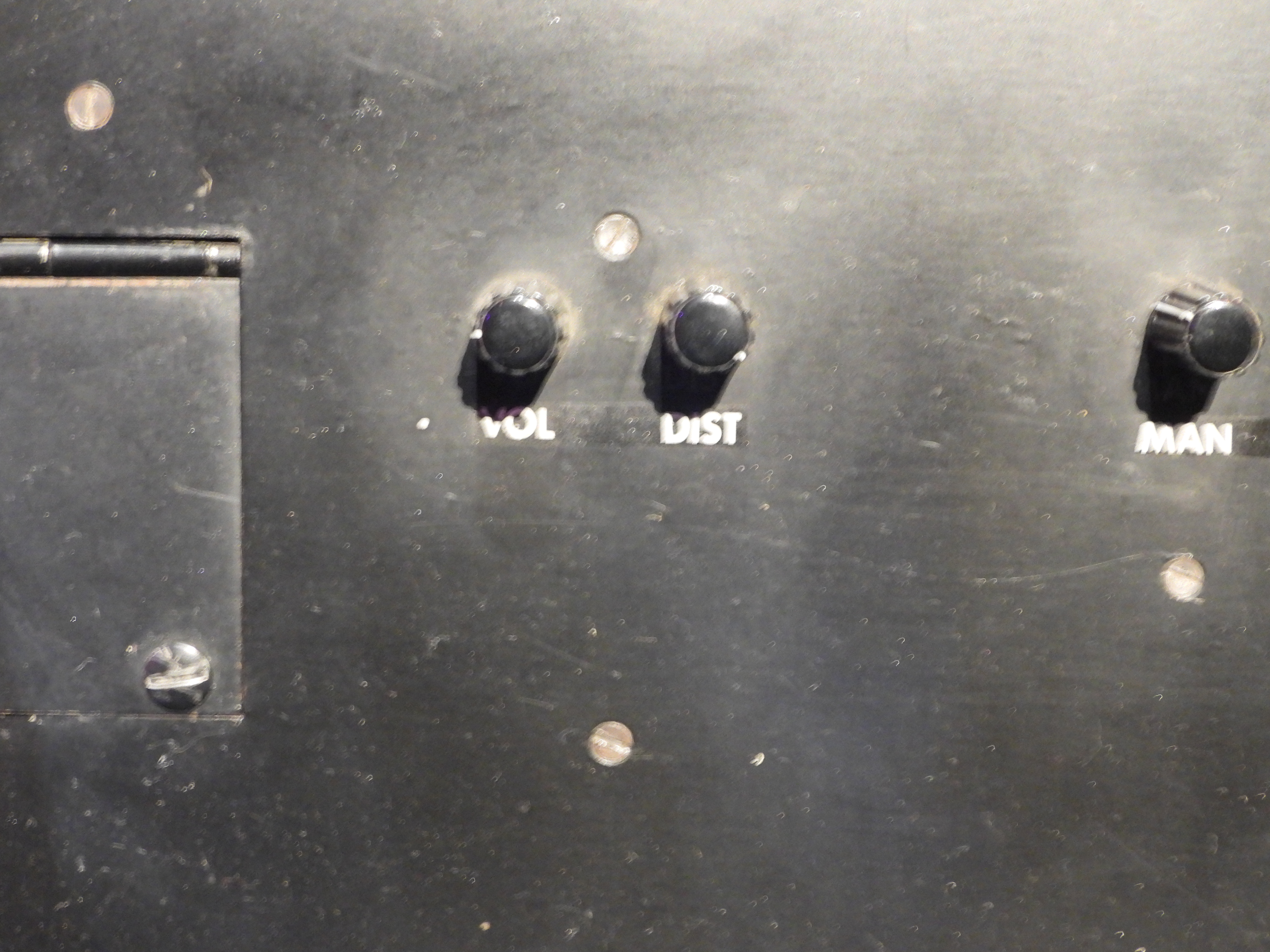

When I saw the outside of the amp Kathy/the family had released, i noted there were FOUR speaker jacks, but the silk screen only showed a line and lettering over two! So, my initial impression was, wow, they added a FX loop in the amp!! However, when I saw the gut shots, I see, nope, there are four speaker jacks in parallel! I think the Tribute amp only has 2. Marshall did have amps with 4 Outputs. Not sure if these were stock or added on. I noted one of the jacks was sitting lower and again, why I thought a FX loop may have been added, but again, the jack could have just been cocked. They ay have added the extra speaker outputs for addl cabinets. In any event, no FX loop added, just addl speaker jacks and does nothing in regards to "Tone".
It's hard to believe he would go to the Marshall factory and request a MOD with addl gain, then not use it! I can tell you using the cascaded, the stages are different and one is bass heavy and why the EQ is such, to boost the mids and get rod of some of that "boom" and bottom the added stage on the normal/bass channel is adding and I'm hearing on mine. How he EQ'd it makes sense, so I think he was using the Cascaded and EQ'ing it....but have been wrong before, like with the pedals in the chip pan being taken our of their enclosures (but that's what Kathy had stated in one thing I read) and being on top, instead of bottom, which was not possible on my unit as I went with Aluminum for weight and Randy's is steel as you can see from rust, but to do Aluminum, you need to make thicker in case stepped on or something, so mine I designed and is 0.100", fyi!

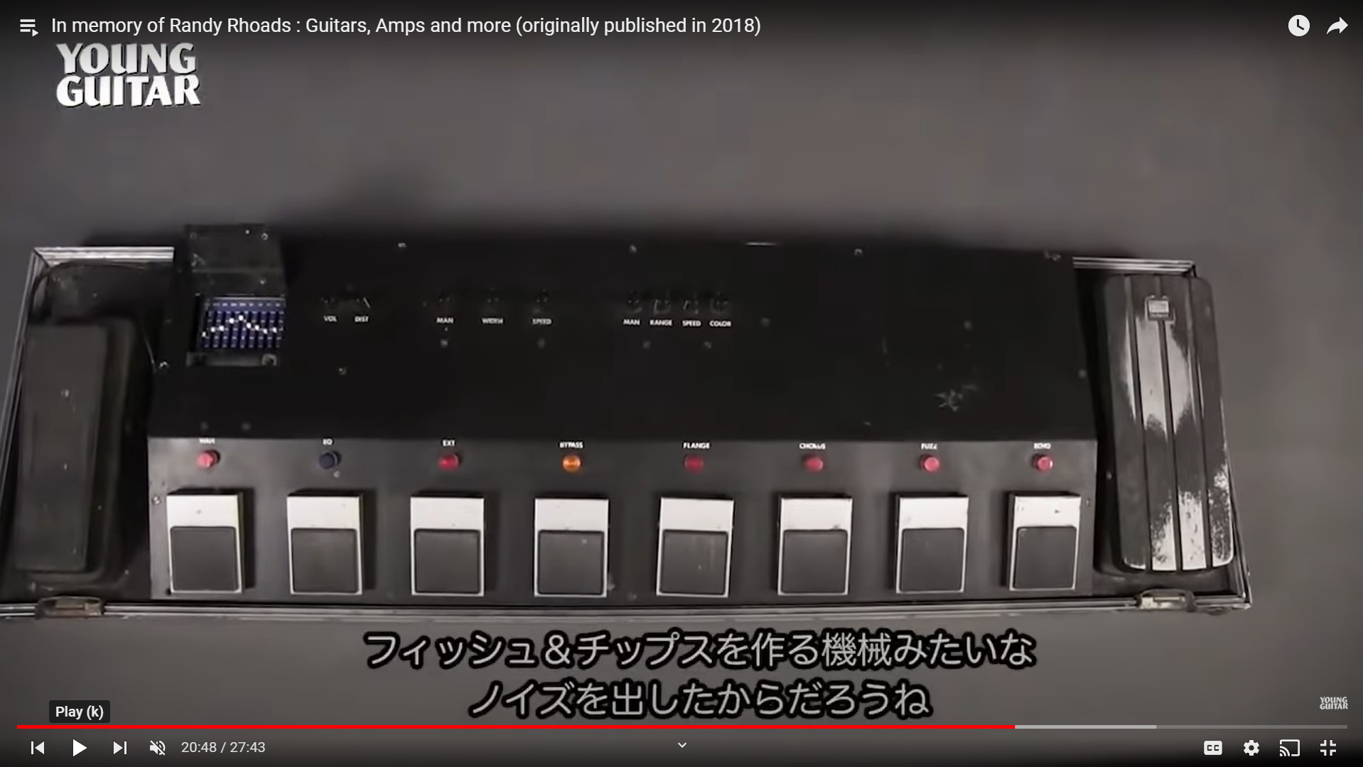

It's really great that all of the pedals IN the pedalboard are MXR. The D+ is very easy to duplicate and if nothing more than a stock unit basically, they can reproduce it, do some graphic work and make bank on nothing more than a stock D+. However, if it was modified in any way, that is going to be gold. The D+ is absolutely a part of the tone and DNA of the D+, but impossible to know, 100%, unless reverse-engineered and blueprinted, but no one better to do that, then engineers and Jim Dunlop himself!
There are some problems cloning the rest of the pedals as all used 120V inputs and internal transformers to lower the voltage, but all used different voltages between the EQ, Chorus, and Flange (12, 15, and 18V)!! Too expensive and ED&D work to engineer and retool and come up with new transformers. Easier to modify the design, remove the transformer and use their isolated power supply to power them. All would work except for the EQ!! The EQ uses positive and negative voltages, so 18V give you 36V of swing.
Another issue is the knobs and specifically the EQ. They don't make those any more, so would need to be tooled up and costly.
The Wah is Dunlop, but Volume pedal Roland, so if doing a complete system, would be a problem and custom/tool up as well as road case.
The looper would have to completely custom, as nothing I aware of exists at MXR.
The D+ and EQ make the most sense and as they already have an EQ and similar frequencies, that only leaves the D+ as outstanding item that was directly correlated to Randy's tone...unless there was other things going on inside like buffering or other things added that we are aware of.

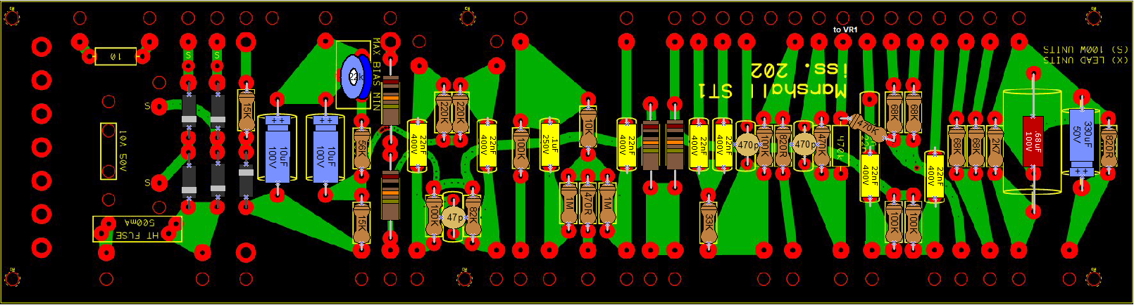

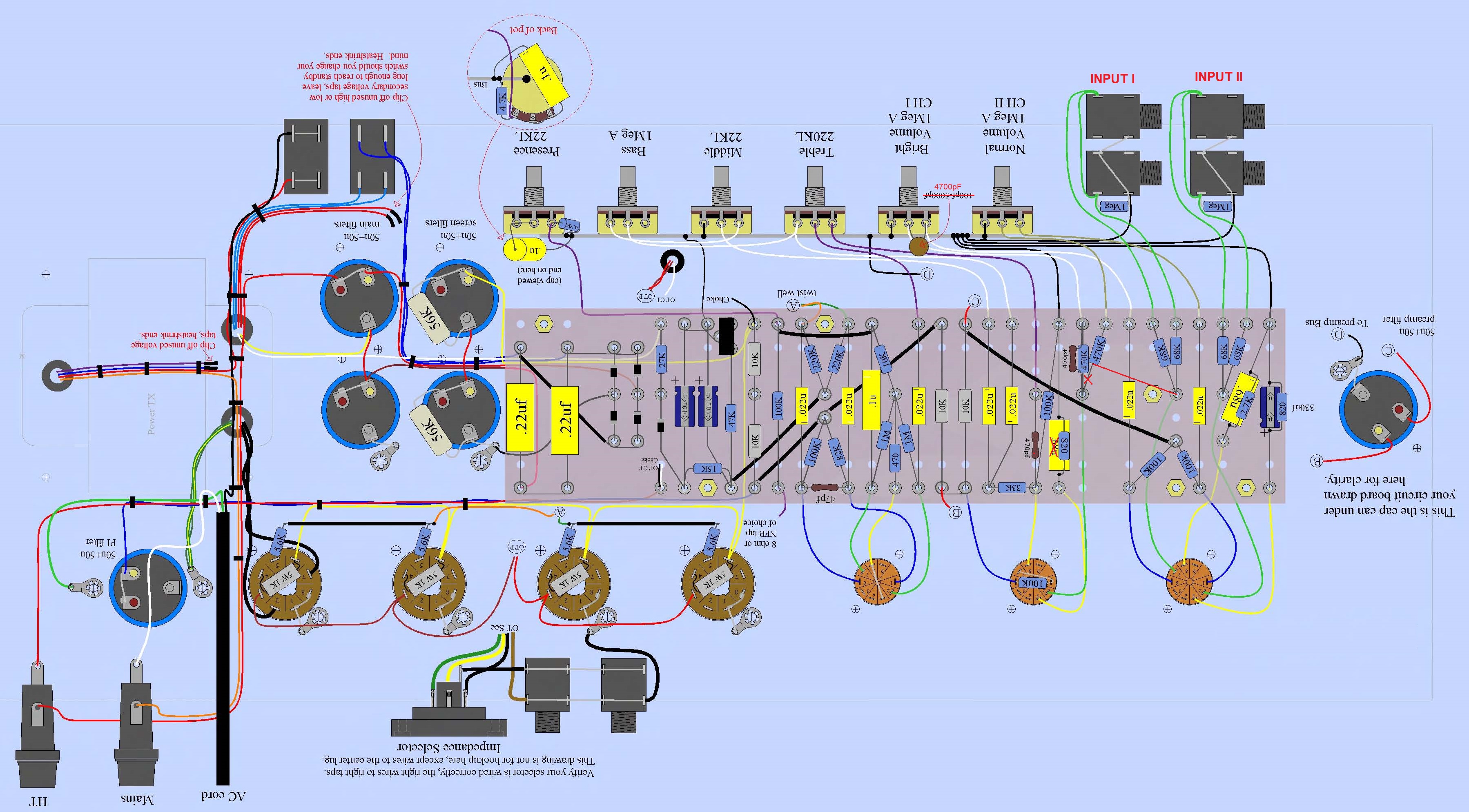

Ok guys, I took a good HARD look at some thing...

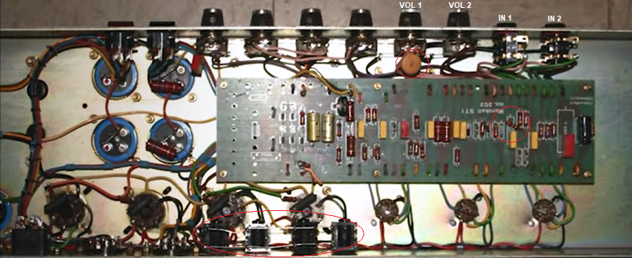

First, I looked at the guts of Randy's actual white head that were posted in a video and when Randy's head were reverse engineered by the folks at Marshall. I identified the one (470k) resistor that Danny said was "out of place" when he looked in there, but was one of the things Marshall was doing to add gain at the request of musicians.
Second, I created a Marshall ST1 clone board and populated it to see what was going on.
Third, I looked at the layout of an era-correct amp to note the signal path.

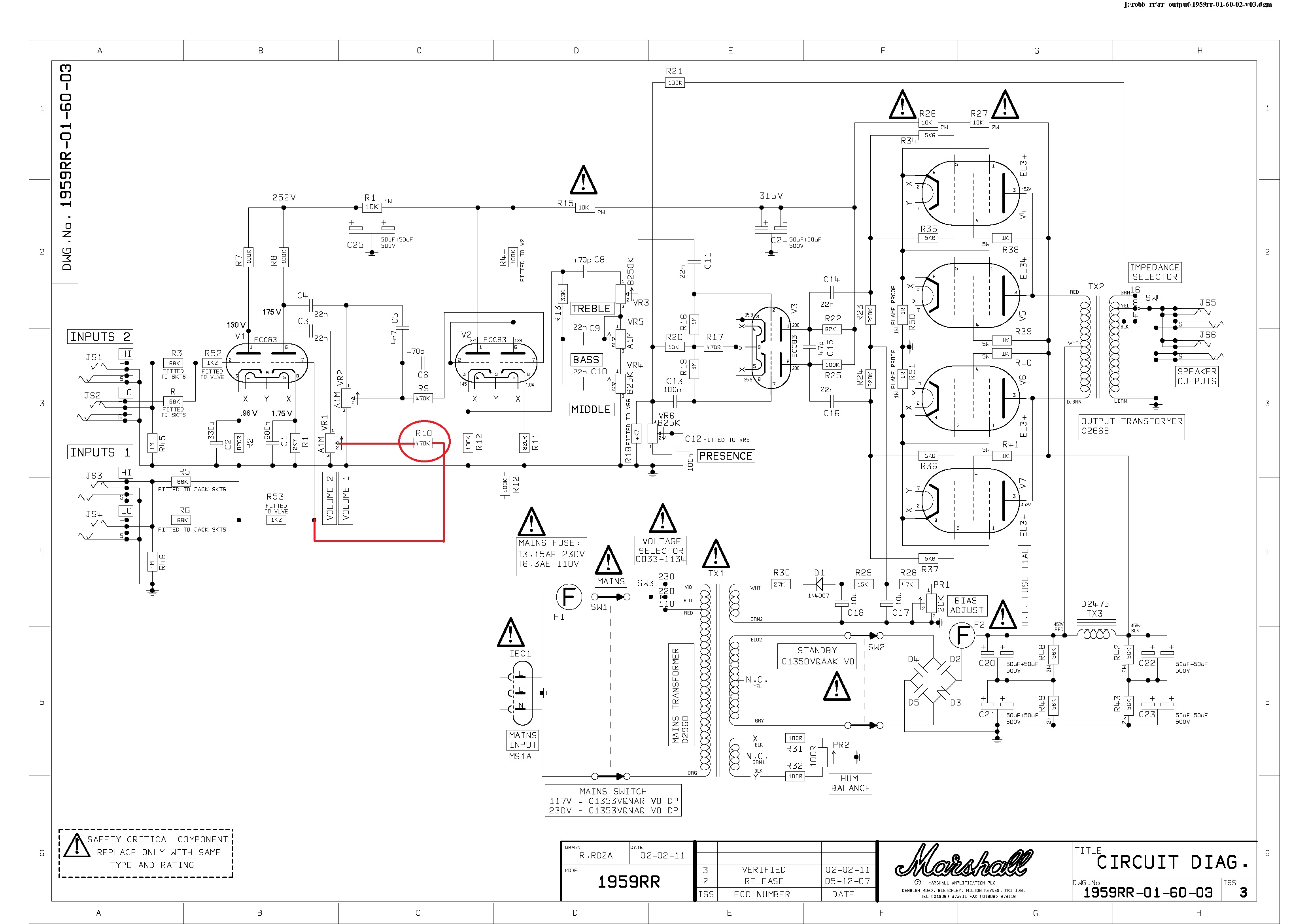

Forth, I looked at the Marshall 1959RR tribute amp schematic.
What I determined was that the 1959RR schematic is correct. That the 470k resistor one leg was moved over from the 470k||470p junction to feed the signal back into V1b. The top-side of the 470k is fed to VR1P2, which is the wiper of the CH II Normal potentimeter.
Therefore, the outboard jacks and pot are for the cascaded mode (INPUT II) and inboard jack and pot for a more Plexi (uncascaded) mode (INPUT I), but with a very bright cap (4700pF) on the potentiometer.
I know there has been a lot of discussion of which input Randy actually used and some suggest it was the Plexi-mode (CH I). However, when I review those conversations and suggested photos, they are with the white speaker cabinets WITHOUT the black tape that was used on the DOAM tour, so I'm thinking those are BOO tour and possibly before he went to Marshall to have the head modified (and could have had the headshell and white speaker cabinets done)?!?
Really, to answer THAT question....would like to see pics of the DOAM tour and white cabinets with the black tape on them. Then we know he last tone, which was different than that previously. As indicated, cascaded does change the tone from more Plexi raw punch to more gain, but rounded off, but I think he may have been using the cascaded mode as that is what he requested and more gain from Marshall, else, he was not happy with the MOD they did, so was just using a bright plexi channel?!?? Any photos would be appreciated.
Now my ADHD is kicking in and since I do have some clone era-correct ST1 boards available...I'm going to take apart by white head and make sure 100% to how Randy's was!! LOL

Hey Flying Dutchman
"By 'beefed up' did he meant adding the 'cascade mod' ?"
Yes. That is exactly what Randy meant.
As far as the inside of Randy's Marshall, the photo I included above with the circled resistor "out of place" Danny Thomas wrote about is Randy's actual amp gut shot, so that is his amp. I did a mark up of a populated ST1 board of the era above also, but will probably do a complete layout so everyone can see how populated and wired up 100%.
As I said, in Randy's actual amp, INPUT I would have been the standard normal mode which is a Plexi with a 2.7k || .68uF cathode, but also 4.7n bright capacitor across the potentiometer. INPUT II would have been adding (cascading) the Normal (Bass) channel with 820R || 330uF cathode into the INPUT I (normal) channel.
Yes, you are 100% correct. The "Plexi" mode is more "raw" and not definition and bass and thump. Cascading adds more gain, but squashed the signal.
For more gain, Randy would need have either needed to modify the amp, which he did, or have a different Overdrive with more gain (modified Distortion+). However, as part of Randy's overall tone...the D+ was essential as it really is a, like he even said at the seminar and labeled on the pedalboard, is a Fuzz OD! Any changes to the OD would NEED to keep the Fizz DNA characteristic, as part of his tone and we all love. You need that fuzz and sizzle on the top end. This is where this initiative by Kathy and the family having the folks at MXR reverse-engineer/Blueprint exactly how it is will finally confirm if any modifications to it, or not. It may be....it may not be...we'll have to wait and see, but in the end, we should/will know 100%.

As I said, the 1959 cascaded with the one-wire mod (resistor moved) mod adds a huge amount of bass with that 330uF cathode cap early on in the amp as it's in the Normal (Bass) channel and cascaded in to the Lead channel. This again, makes the bottom flubby and untight and reason the EQ would be needed to voice and correct these things along with what the rest in the signal chain, speaker, and cabinet would be doing to the end-tone!

#1 The Distortion+ - Was it stock or modified?? We'll find out.
#2 The Wah - Again, was it stock or modified??
#3 The Volume Pedal - Was this stock or modified??
The volume is a tone Robber and due to the amount of deflection of the pedal and coinciding with the rotation of the potentiometer, from fully down to fully up on a stock unit, you can't get the full throw of the pot! So, let's say it's a 100k pot...you only get, 50-100k - half cocked to full on, OR 0-50k - Off to half-cocked!! Soo, either you compromise one way or the other, OR it was modified. Between the two and if not modified, half-cocked to full on would be the way, else your tone would be compromised and be setting the gain, EQ, and distortion up to compensate.
