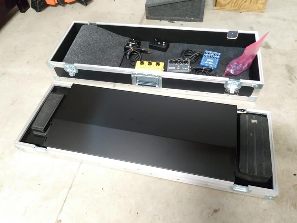

Hy Guys
I'm a Randy Fanatic. God Bless him.
I recently decided its been long enough. I wanted an exact copy of his entire rig!!
I already had a Les Paul Custom of the same type and Norlin era and pickups and all. I had previously cloned the amp and cabinet.
Recently, I went all out! I purchased all of the vintage pedals (I was shocked that back then, they were all 120VAC instead of 9V, has a custom ATA flightcase built to the correct dimensions, finally by taking all of the photos and triangulating and figuring out the pedalboard dimensions, reproduced the pedalboard, which arrived today!!
I will be drilling it and wiring it up after the holidays to finalize it!
Looking forward to it, but thought I'd post and share and that you guys would gt a kick out of it!

Really keen to see how you go about this. Do you know the signal chain?equinox wrote:Hy Guys
Long Live Randy Rhoads
Gonna use the same sup and signal chain as been communicated for over 30 years on the web and by Wolf Marshall back in the day. - http://www.guitareuromedia.com/wp-conte ... 6bf263.jpg
Chain is Volume=>Wah=>Distortion+=>EQ=>Flanger=>Chorus=>Reverb/Delay
I have NO idea the actual lamps and BOSS-type pedals he (the builder) used, but what I will do is use LED's for lights and 1/2" 3PDT switches to switch the signal and activate/deactivate the indivudal lights. The LED bezels holes as well as the switches should be SMALLER than the original, so once and if I even find out what they were or fabricate a BOSS-style pedal, I will swap them out.

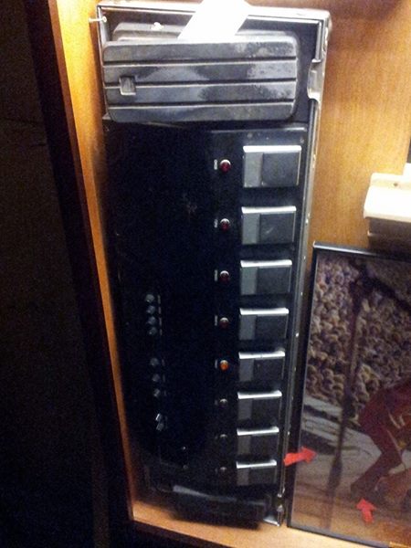

Where was that photo of Randy's stuff (pedalboard, shoes, photos, awards, etc)?? I'm assuming Musonia or Kelly & Kathy's?!?? Being the original stuff and as someone pointed out, recent award...who else would have access to that and it shows recent!
Would be nice if they would open it up one time, like the amp and guitar case for the tribute 1959RR amp and Les Paul, do document and show what's inside. One clear and Hi-Res photo would be adequate (more preferred).

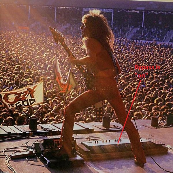

some interesting notes while going thru photos...
the most interesting to me was the plate in the upper left shown in photos and in the rig setup. the chain showed the MXR EQ used. In the one picture, the door is open and you can clearly see, that is where the EQ is and door is there to keep from settings getting moved, but I can clearly see what the settings are and looking forward to applying them! good information and photos!

I'm still not sure about the position of his Wah pedal in the signal chain, why would it placed on the pedal board at far left while according the 'Wolf Marshall' chain description it came second after the Volume pedal? Also I heard that extreme filter effect Randy created with his Wah pedal at times can be achieved easier when the Wah pedal comes after the boost section. (so after MXR distortion and EQ) If so the signal chain from Wolf Marshall is not correct.
But of course still possible it came right after the Volume pedal since we can't see how the board was wired inside... who knows!

Really should get a hold of Pete "Pedalboard" Holmes (if he's still with us), Wolf Marshall, and Kelle (Doug) Rhoads. All I/we need is a good hi-res photo of the inside and possible the back with all of the inputs.
Looks like the Wolf Marshall Rig sequence is right with the input toward the volume pedal, just on the wrong side of the pedalboard.
Interesting in the one photo also, there really looks to be SEVEN jacks, 1 input and the 6 others, as the Rig shows only 5! Soo, what is the other set for??
Really need shots of the inside, and back.
I want to make sure this is 100% before building and finalizing.

Keep in mind Randy likely moved things around regarding the signal chain while on tour..
His wah pedal was routed into the effects loop for a good portion of his Ozzy time. This is why it was so overpowering and really couldn't be used in the standard wah format you would expect. Just listen to after hours version of I don't know at the very end. Randy is looking over at Rudy and laughing about it, Rudy and Tommy likely never heard anything like that before and were only exposed to it a couple weeks prior when they joined the banned. I have never heard a wah scream like that from anyone before or after Randy.
I think during June/July 1981 is when he had the signal chain changed. The wah was moved back in front of the amp as the wah "scream" at the end of I don't know is nowhere near what it was earlier in the tour. The wah sounds more like a standard wah when he used it during the middle of Children of the Grave during the Montreal show. During this time frame is when I think he placed the chorus in the effects loop which gave him that glassy sound from June 1981 to the end of the Blizzard tour. Prior to this I believe he had the chorus in the front of the amp, not standard practice but I am pretty sure that's what he was doing.

None of the diagrams state this but I think one or more of his pedals may could be switched in an out of the effects loop via one of this pedals. It's literally a 5-10 change that any competent tech could have been implemented.
