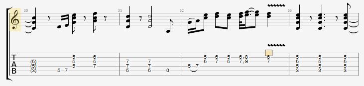

So the other day I was playing Mr. Crowley and something I’d played many times took on new life. Look at these measures and what do you see?
So often I'd played this, just playing what was written. This time, however, the first measure suddenly became a C chord and an F chord (the F being a CAGED C form chord minus the 8th fret A string ‘F’ note). Then, in the 3rd measure, I ‘saw’ C, Dm, Em, Dm – and ‘heard’ (in my head) Randy talking in a lesson about playing ‘broken’ chords. When I heard him say that in an taped lesson years ago I glossed over it. The other day it clicked, he was talking about what I know as partial chords when he said broken chords.
It’s this kind of thing that pops out from time to time that fascinates me about Randy’s playing. I hear it in a whole new light now.
By the way, the C to F in the first measure there is a very common ‘70’s rock cliché. I hadn’t noticed it in Crowley before but I’ve been playing a lot of ‘70’s stuff lately, so it jumped out at me this time.

I remember reading that he was getting into Larry Carlton right there at the end. These days it's normal for players to quote all kinds of influences, but back in those days you only quoted guys in your genre.
The thing with the first measure cliché is that I first noticed it in quite a few KISS songs - in fact a LOT of KISS songs have that in them, I'll have to look, but I'm thinking they are the Paul Stanley authored ones. Anyway, I then started noticing it elsewhere and, later, I came across this video:
This guy found the same thing in Keith Richard's playing. When I started looking, I found it explained in Desi Serna's CAGED DVD and again in a recent Steve Stine CAGED lesson - check this out at 5:47...
Another thing that was an 'epiphany' is the lick during the 2nd chorus (at the same point). I always had difficulty remembering the fingering for that and would slow down there. Then I 'saw' it as descending in D minor and it clicked. I was actually playing a 3-note per string F major scale prior to playing Crowley, so when I go to that lick it sounded familiar... D minor is the relative minor to F major, so I could see the context.
Ever hear the saying, "He can't see the forest for the trees"? That's where I was. I was focusing on the fingering and when I stepped back and saw the context it all made sense.
Randy's legacy in action: he's still teaching us new ways of see things in his playing.
