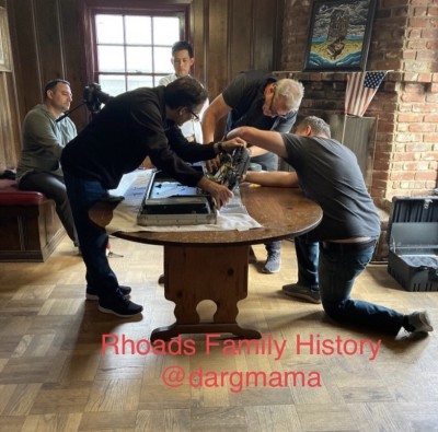

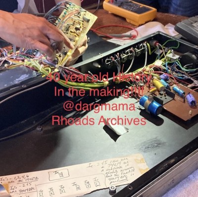

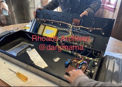

Finally a full pic of the inside board.. Kathy posted this yesterday.
And to consolidate all detailed pics of Randy's pedalboard in a single post, here are some more. As I find them I will update the post and credit the owner.
**Someone posted some high res photos from the HOF exhibit of Randy's board last year, can't find them. Let me know and I can add them to the first post.

It's great to see they used tie straps once everything wired up to try and keep everything anchored.
Not sure how the MCR 10-Band EQ is secured to the pedalboard. It may be siliconed and you can see the foam spacers on the bottom to take up the gap. What I did was drill thru the holes that fasten the bottom to the pedal and thru the top. Holes are matches up so 4 screws go thru the pedalboard top and into the holes I drilled thru the top of the EQ and taped for proper threading, fyi.
On the controlboard (next to the flanger), it looks like they may have indeed used relays! I see at least 7 and see-thru contacts (up near the blue wires on top)! I used something much simpler and available at the time with 555 timer and transistors working in a flip-flop circuit, fyi! Simpler and relays are a more expensive component at $3-5/each.
There has been a lot of documented of information on the board acting up over time and yes was dropped at one point, but over time and soo many miles on it, the capacitors are all dried up and sucked compared to moderns, so if one was to get it back up to 100% running condition, I would replace ALL electrolytic capacitors and likewise, check and see if the relays became weak over time.

The one thing I don't understand is how the potentiometers in all the pedals go thru the pedal, then the pedalboard top. I mean, on mine, I tried that and there was not enough threads, so thought maybe longer shafted pots may be used, but it's probably due to thickness.
I didn't want my pedalboard to weigh a tone. Randy's is steel and you can see surface rust on places.
I went for aluminum, but to ensure did not deflect (nor rust), went for .100" thickness and this must be all the difference. Randy's is all attached to the top of the pedalboard, where mine, only the EQ is. The rest, I ran 3-wire harnesses that have snap disconnects for each of assembly and disassembly!

Looking up the datasheet for the IC's they outlined....looks like they HEX SCHMIT TRIGGER and Flip Flop to switch the LED on/off and flip/flop the relays on and off, so not so different than what I did, but using readily available NPN and PNP transistors at the time instead of ICs!!

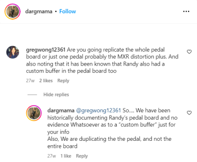

One thing to note is Kathy's response to the question if the pedalboard had a buffer in it, which she confirms 100%....NO buffer!

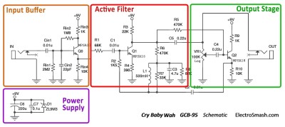

I thought maybe some of the pedals have a buffer circuit in them and maybe that was the confusion? The D+ does not have a buffer, nor the volume pedal which the signal is supposed to come from guitar, thru the volume, then into the pedalboard as the wah can be disabled thru one of the loops in the pedalboard, but the wah does have an Input buffer at the front of the circuit, fyi.
