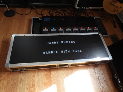

Looking forward to checking it out and if any different from my era-correct versions and if so, swapping out the pedal in my pedalboard and putting this journey I started 5 years ago and baby to bed.
In all honesty...I really think the D+ was stock!! I played thru my pedalboard the last 2 days and with the D+ AND EQ engaged into the amp with appropriate modification like Marshall did back in the day and Altecs....the tone is SPOT ON stock!! :O
We will see.
Oh, and if anyone is interested what the entire pedalboard and road cost cost me with era-correct pedals and the custom looper....It was about $4,500!! $2,700 in parts and $1,800 in labor given the amount of man-hours and at my pay grade!!
