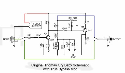

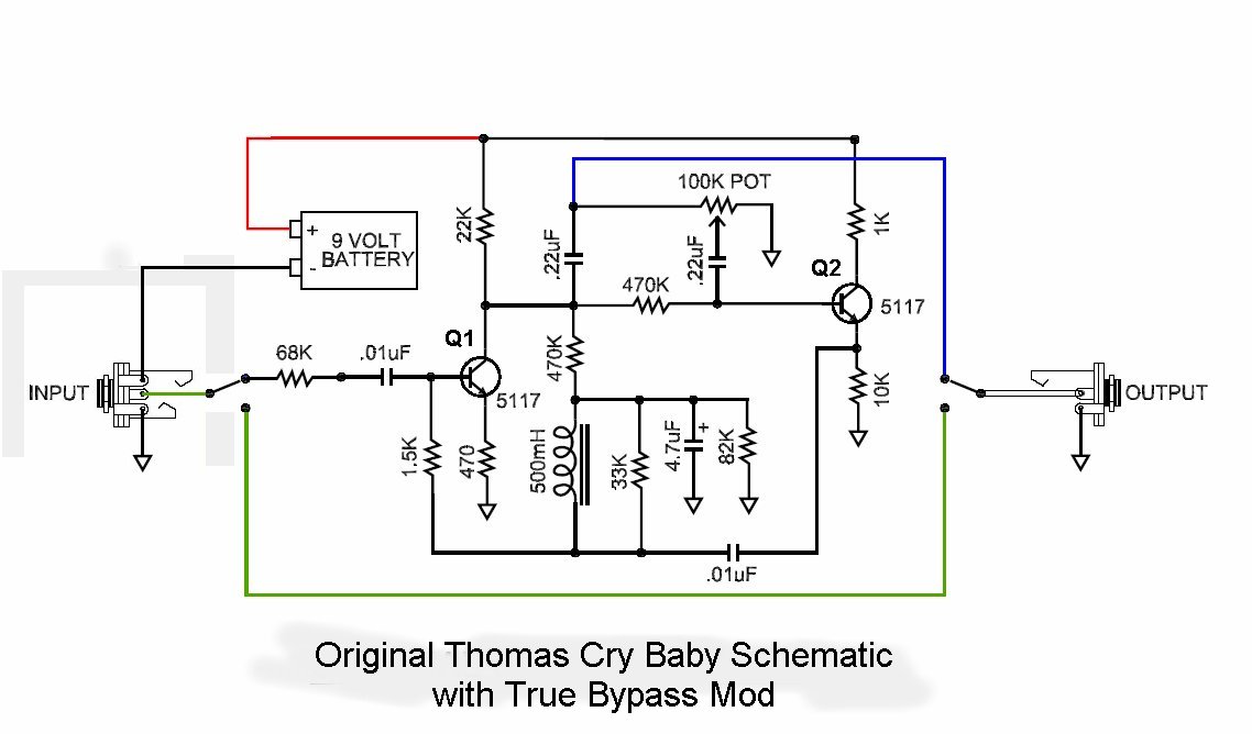

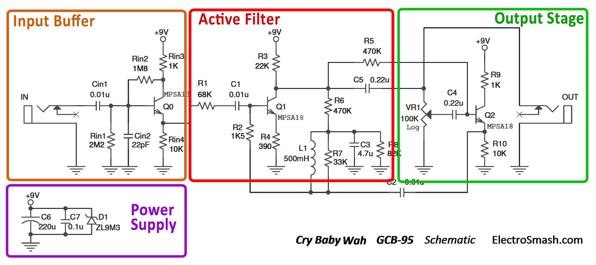

Looking at the schematics, the vintage pre-1982 units versus modern post-1982 units are quite different! Not a lot of difference between the vintage units, so don't think so much difference between California, Chicago, and Italy units.
I did a quick search locally and was able to actually find an all original California unit for sale, so picked it up for a modest $130!!
I have a modern Dunlop GCB-95 unit also, so will be making sure the vintage one is all good and check all components and once confirmed, I'll A-B it with the modern Dunlop and see if there is any significant tone differences!
I will be replacing the GCB-95 with the Thomas Organ unit on the pedalboard, where it should be!
Thanks again for the heads up and attached are the Thomas and modern Dunlop schematics for reference.

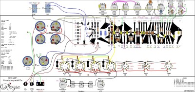

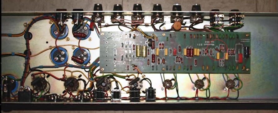

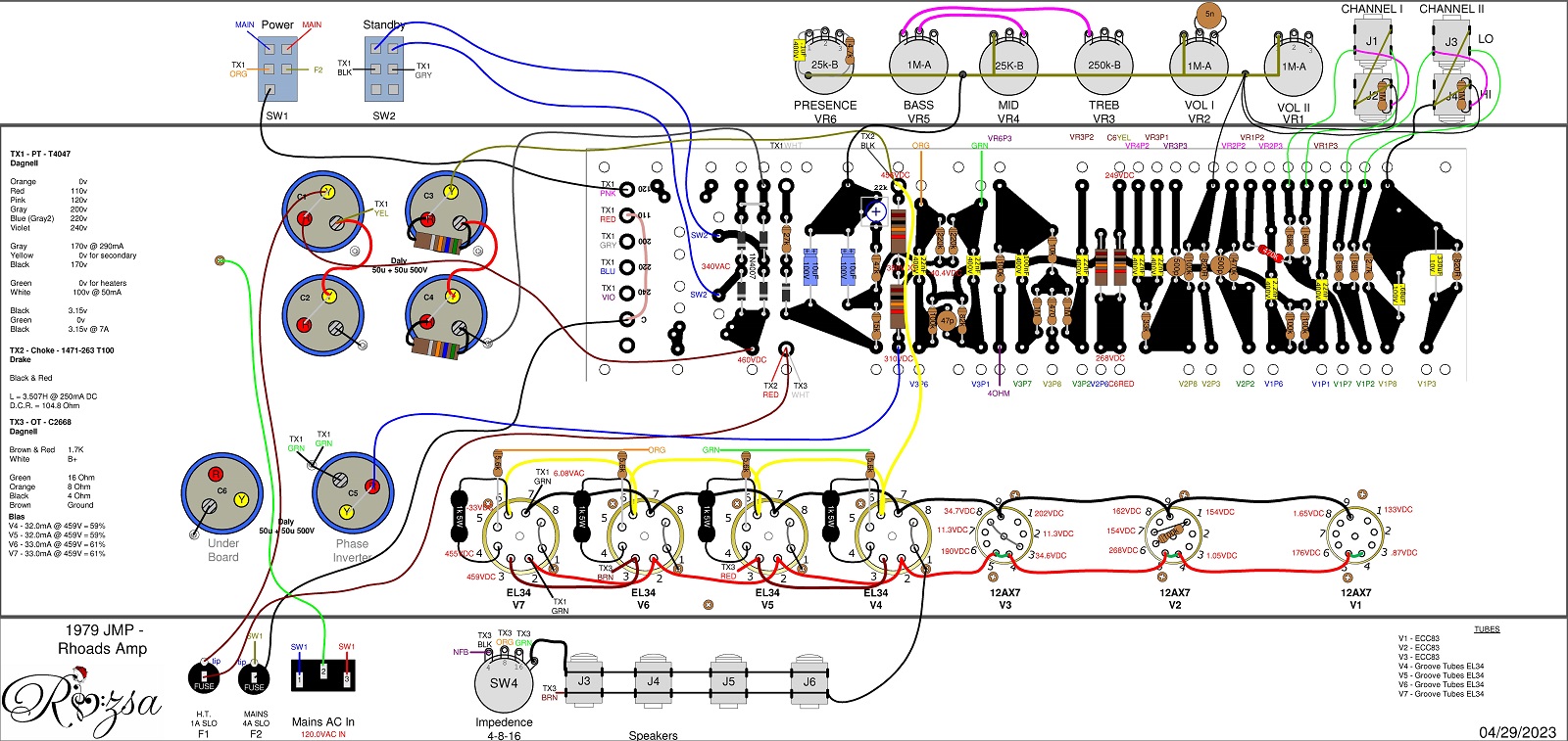

Spent some time with the amp today. Amazingly, Marshall must have ran out of 820 ohm resistors, as mine had a 1k in it, which in itself is uncommon to Marshall, but ran out and grab the next closest value. Issue is that there is about a 22% difference with this one component!! So, I corrected and still made reversible, by just adding a 4.7k resistor in parallel which makes the overall resistance 823 ohm...PERFECT!!
I spent sometime with it but NEED to make a video for everyone to see and each channel and with the potentiometer pushed in and pulled on each channel. I also added the D+ and EQ settings available and although the "Tribute" amp you plug into the CHANNEL II input, I can honestly say from hearing the amp, Randy I believe used Channel I and as others suggested and from live photos. The reason I thought not was the signal running from Normal to Bright channel, but I can report back that is not the case and with the MOD applied exactly like Randy's head. It's plugged into CHANNEL I!
Attached are photos of Randy's actual amp and circle showing the MOD with the 470k resistor moved, the layout of his actual amp I created, and his amp design, but with a traditional Post-Tonestack Master and the resistor MOD on a push-pull switch potentiometer (as mine currently is).
Enjoy!
Enjoy!

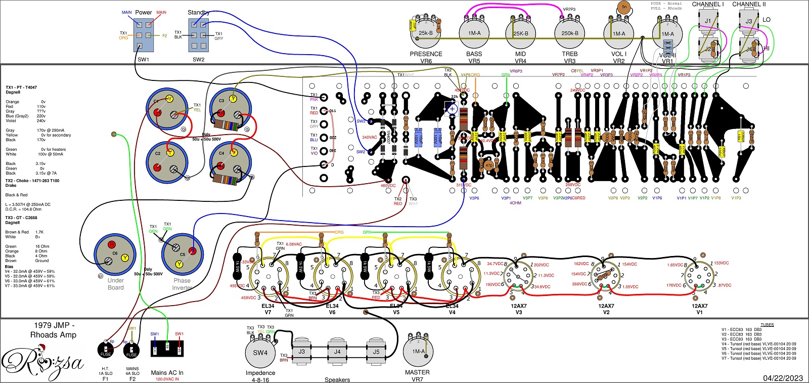

No sweat. Glad I have the engineering skills and know-how to contribute, as well as Jim Dunlop taking a look at that MXR pedal and see if anything different under the hood. No word yet after 5 months. Hope they don't wait until like Christmas or something. Just figure it out and what you want and release it guys. It doesn't have to be any special date. Us Rhoads fanatics just want to know and the real truth. Thanks in advance.
I'm attaching a couple updated layouts for Randy's amp and also my MODified clone with the MOD on a push-pull and post-Tone Stack Master (traditional). I've played with the amp for hours and between the Channel II and Channel I, Channel I actually sounds better as there is too much bass introduced into the amp thru the normal (bass) channel, then into the lead (bright) channel. This is what you guys were alluding to in the pic of Randy playing and communicating he plugged into Channel I-HI. Based on what I'm hearing I have to agree with that!
The MOD....DOES to something to the amp on the normal-side thinning it out and making it not so Bass heavy and seems to add gain to it! I'll have to post on that and what it is doing. It's really amazing to get "the" tone, you can just have an amp and speaker cab, it really is sum of the wholes! It's taking the amp with modest gain, bass heavy, running it thru the MXR for more gain and saturation, then thru the EQ to voice it and get rid of bad characteristics while increasing ones that are advantageous. Then at that point you have good tone, but not done yet!....then you throw it thru the Altec, which are COMPLETELY different than Celestions and don't add any further dirt to it as high wattage clean speakers, but with the aluminum cone cover gives the glassiness, ghosting and more high end to cut thru a mix before you get the OVERALL tone and you HAVE To have ALL of the items to get there, else you're 50%, 80% there!!
I already blueprinted the 1979 amp and did the layout and took all voltages. The voltages are similar with what the Tribute amp had and 460V on the plates of the original and about 310-315V on the Phase Inverter for both.
Next Steps: I will convert the Tribute clone amp I built to Randy's original MODded amp (built up the bare PCB last night) and A-B to ensure no difference, then I should be done with this exercise!
