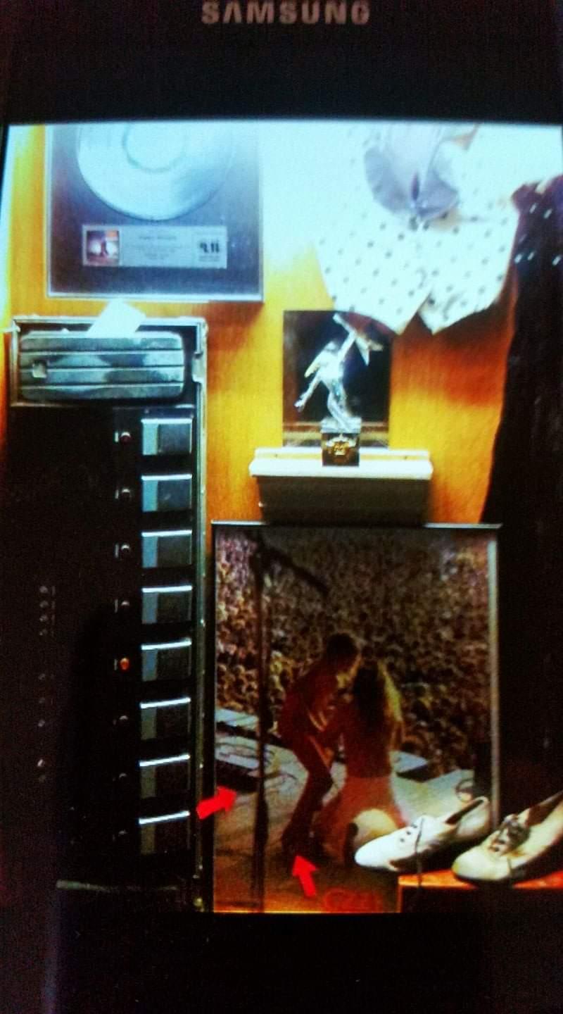

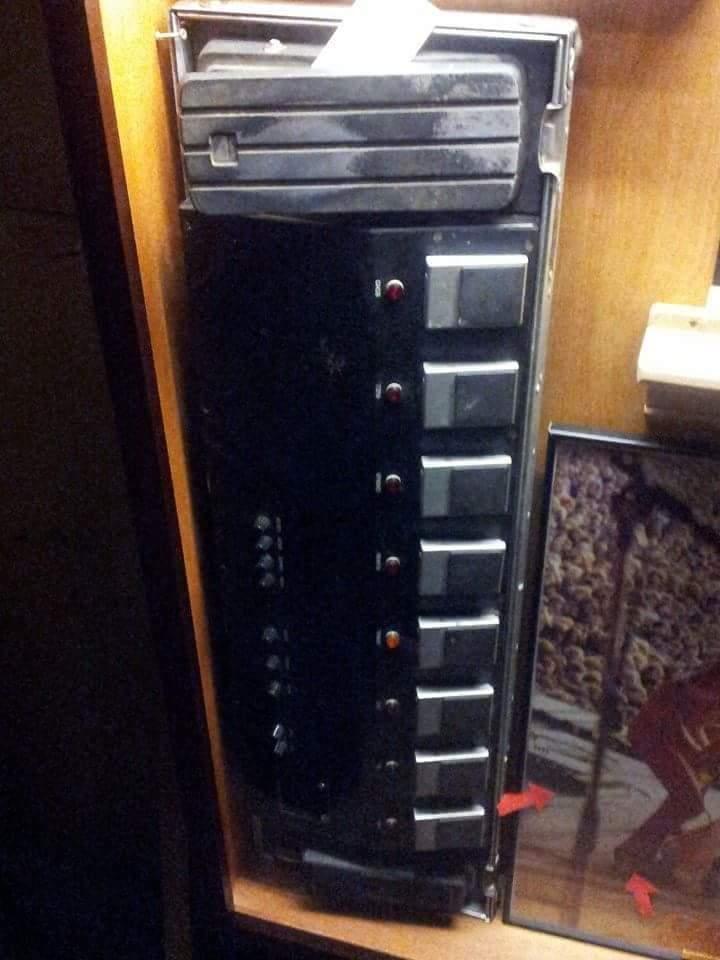

These pics should be very interesting to you, look closely to the 'yellow' boss style pedal on top of the pedalboard.equinox wrote: the kind of information I'm looking for. Imperical proof
I think he used the Boss OD1 there. It's hard to say if this pedal was plugged in the external loop, maybe you can figure out when zooming in, if it was the Boss OD1 and in the external loop, this may say something about the position of the external loop in the signal chain.
(yes this is also a bit speculation, but the pics are not and may give you more insight)

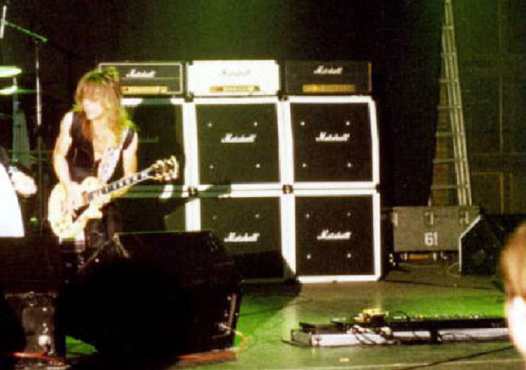

Yeah, I don't know about the OD1.  I see the input is pluged in, so hooked up somehow whether activated or not.  Maybe he needed something for the gig and the Distortion+ was not working or maybe later favored it over the Distortion+?!?  These are the first pictures I've seen of this.  Looks like his tech (Pete Mertens) is kneeling behind him on the right in the one photo!   In the other I noted again...the slant cabs actually on TOP of the straight cabs!  Very cool.

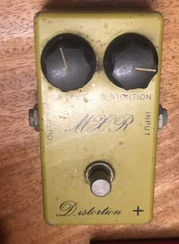

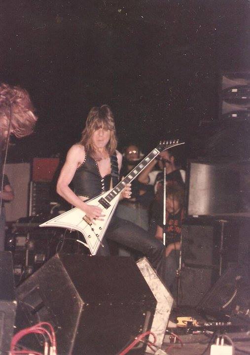

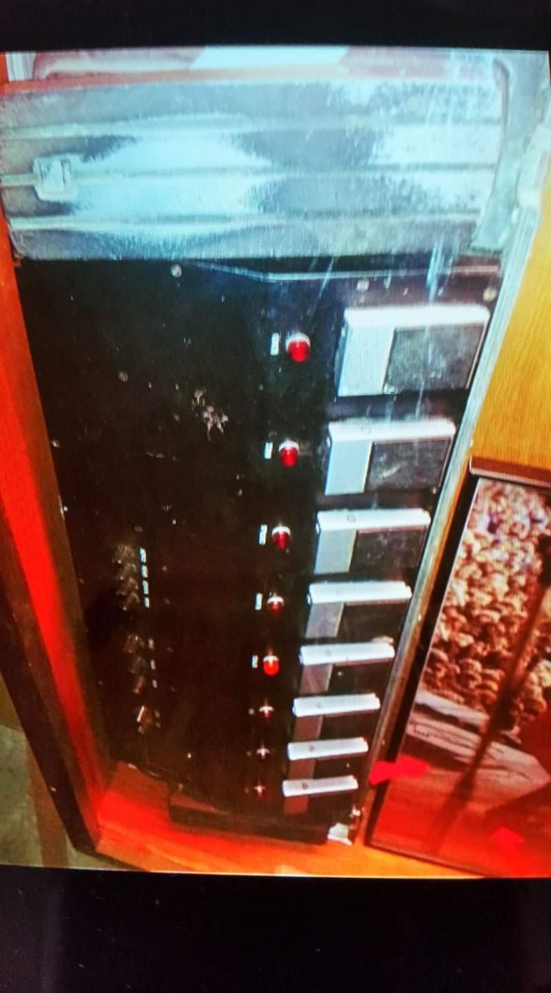

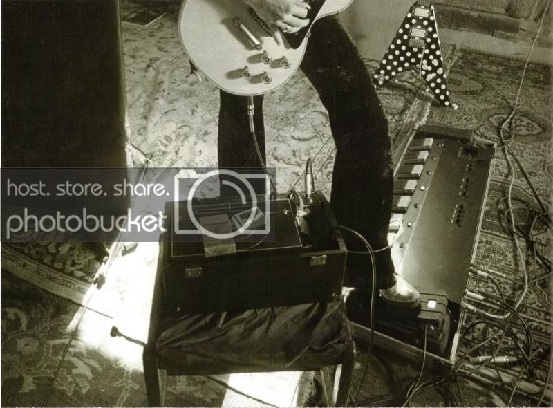

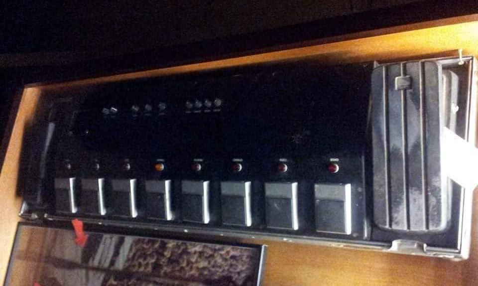

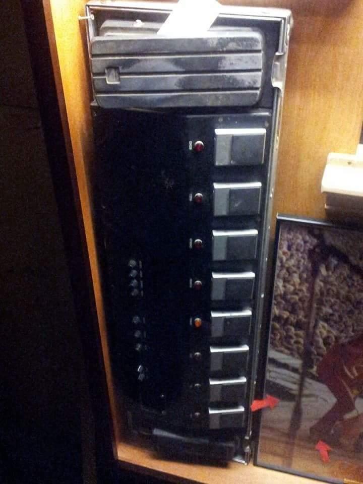

Friend sent me these photos.  A few things to note....
1. The settings on the stand-alone Distortion+ and the one inside the pedalboard are identical! Soo the correct settings on the VINTAGE pedal are distortion just past 3 o'clock! There are 2 ways to run this pedal, just like an amp...distortion up and then volume, or volume up and then distortion and I heard 2 both opinions. I would say this puts this to bed and it's Distortion up, then volume to the rest of the rig. On my '79, this is when the "sizzle" kicks in and the love comes out. You have to watch it between this and "10" as it gets unstable and out of control, so you have to watch it and put it in that area. You can see the stand-alone next to the Marshall and Fender Harvard in the one photo.
2. These additional pedals are fairly hi res for the time, so I can triangulate positions of things including knob placement and where the 1/2" holes for the 3PDT switches need to be as well as lamps/LEDs.
3. Again, on the one where he's stepping on the volume...I can see 6 jacks and on the side of the volume. 1 stand alone as Wolf calls out as the Input, and two pairs for loop. The lip above the flight case is only like 1"-1.5" soo, the jacks are running horizontally, and doubt stacked any vertically. As seen in the previous, the IEC 120V input is on the Wah side. Not sure what I'm gonna do about the EQ. It has a trapdoor style that flips open, hinged in the back and when closed forward, two screws to fasten it! 1. Not sure How I'm going to do this quote yet, but 2. makes sense to make this this way to I. keep the slides recessed and locked-out to keep from getting moved and 2. keep dust and dirt out of the sliders Any suggestion would be appreciated.
4. What's up with that tape-unit in the photo with his foot on the volume?? That looks like a unit my brother-in-law had in the late 80's and kicks him self is the ass for selling it. It was like a looper and was VERY cool.

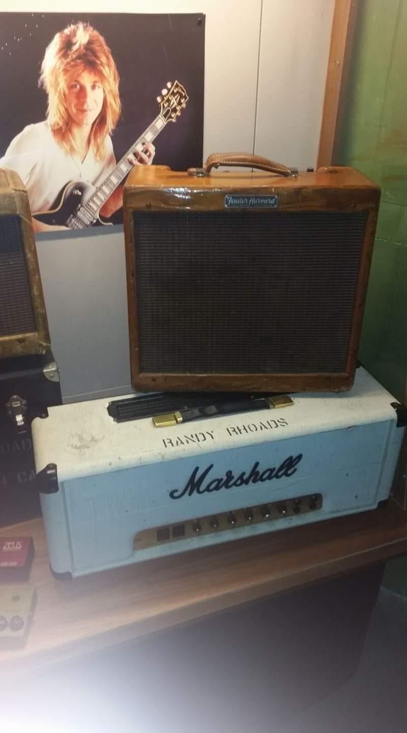

5. Likewise, what's up with the Fender Harvard?? Randy had one of those he used??

1. Makes sense. Randy told me to set my dist+ (both knobs) at 10:00.
4. Randy used his Echoplex more extensively with Quiet Riot, I think.
5. Randy kept his Fender Harvard at home. This is the amp he auditioned for Ozzy with

Bernie Torme said that the board was turning pedals on / off like it was being operated by somone with a remote control. I've got the article in a mag some where it's a good read.
i remember that article. if it was me i would have ran off the stage!
