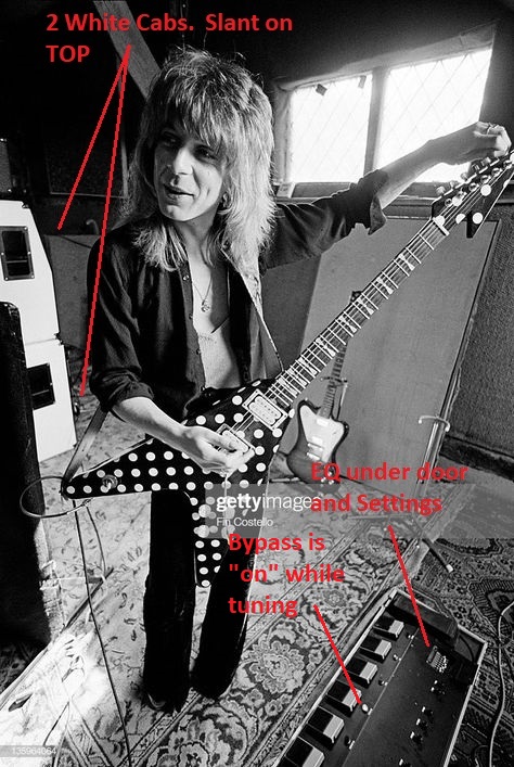

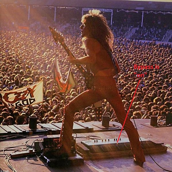

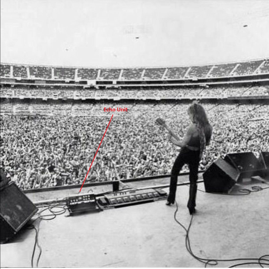

some interesting notes while going thru photos...
the most interesting to me was the plate in the upper left shown in photos and in the rig setup. the chain showed the MXR EQ used. In the one picture, the door is open and you can clearly see, that is where the EQ is and door is there to keep from settings getting moved, but I can clearly see what the settings are and looking forward to applying them! good information and photos!

Really should get a hold of Pete "Pedalboard" Holmes (if he's still with us), Wolf Marshall, and Kelle (Doug) Rhoads. All I/we need is a good hi-res photo of the inside and possible the back with all of the inputs.
Looks like the Wolf Marshall Rig sequence is right with the input toward the volume pedal, just on the wrong side of the pedalboard.
Interesting in the one photo also, there really looks to be SEVEN jacks, 1 input and the 6 others, as the Rig shows only 5! Soo, what is the other set for??
Really need shots of the inside, and back.
I want to make sure this is 100% before building and finalizing.

Keep in mind Randy likely moved things around regarding the signal chain while on tour..
His wah pedal was routed into the effects loop for a good portion of his Ozzy time. This is why it was so overpowering and really couldn't be used in the standard wah format you would expect. Just listen to after hours version of I don't know at the very end. Randy is looking over at Rudy and laughing about it, Rudy and Tommy likely never heard anything like that before and were only exposed to it a couple weeks prior when they joined the banned. I have never heard a wah scream like that from anyone before or after Randy.
I think during June/July 1981 is when he had the signal chain changed. The wah was moved back in front of the amp as the wah "scream" at the end of I don't know is nowhere near what it was earlier in the tour. The wah sounds more like a standard wah when he used it during the middle of Children of the Grave during the Montreal show. During this time frame is when I think he placed the chorus in the effects loop which gave him that glassy sound from June 1981 to the end of the Blizzard tour. Prior to this I believe he had the chorus in the front of the amp, not standard practice but I am pretty sure that's what he was doing.

None of the diagrams state this but I think one or more of his pedals may could be switched in an out of the effects loop via one of this pedals. It's literally a 5-10 change that any competent tech could have been implemented.
