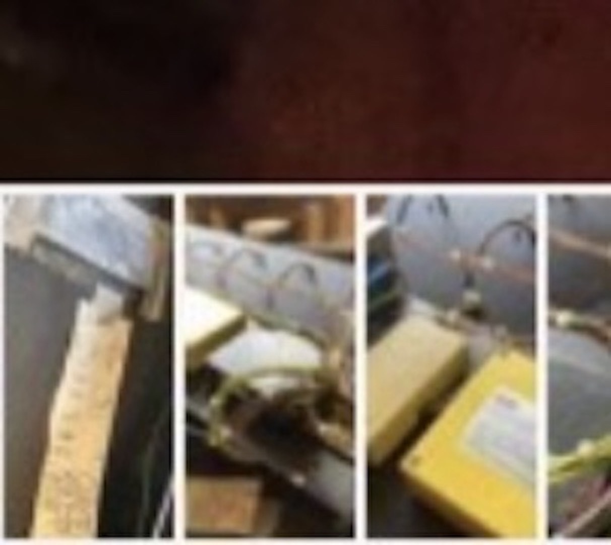

Below is the original uncropped photo that I posted earlier in this thread showing the guts of Randy's pedal board. This is Kathy's original instagram story post in which she was preparing the white Jackson and other items for shipment to the RRHOF. The items were shipped around July 8th so she was documenting the condition of everything inside and out.
There are many photos of the white Jackson if you look at the thumbnails in the pic, then at the bottom right she started taking pics of something else and 3 viewable thumbnails are obviously of the inside of the pedalboard, to me at least. The next pic is the zoomed in pic of those last 3 thumbnails. The pedal layout, wiring, LED's, and foot switches, and really old wiring all line up with it being the inside of the board. You can even see the angle in the sheet metal where it drops for the foot switches. I could be wrong but I would bet any amount of money that that is the inside of his board.
Shockwave
I know you're hot and hard about believing the photos to be authentic and PCBs and nt taken out of the enclosures and just epoxied in or whatnot....BUT, it doesn't make sense!
For 1 - The family left comments for the artifacts including pedalboard and they said the PCB's are taken out of the enclosures.
But further 2 - As we can see in my photos, there are holes/screws on the top of the pedalboard and below the pot/knobs! There would be no need if the pots were holding the pedals in and the location of those holes do not line up with say the back plate mounting holes and make NO sense where whey are located if that were the case!!
I would say you are incorrect in your opinion based on the above. The family comment would be enough, but also knowing the weird location of the screws and holes...makes no sense to put them there and thru the pedal.
So, let's put this to bed and agree with the family that they are just taken out of enclosures.

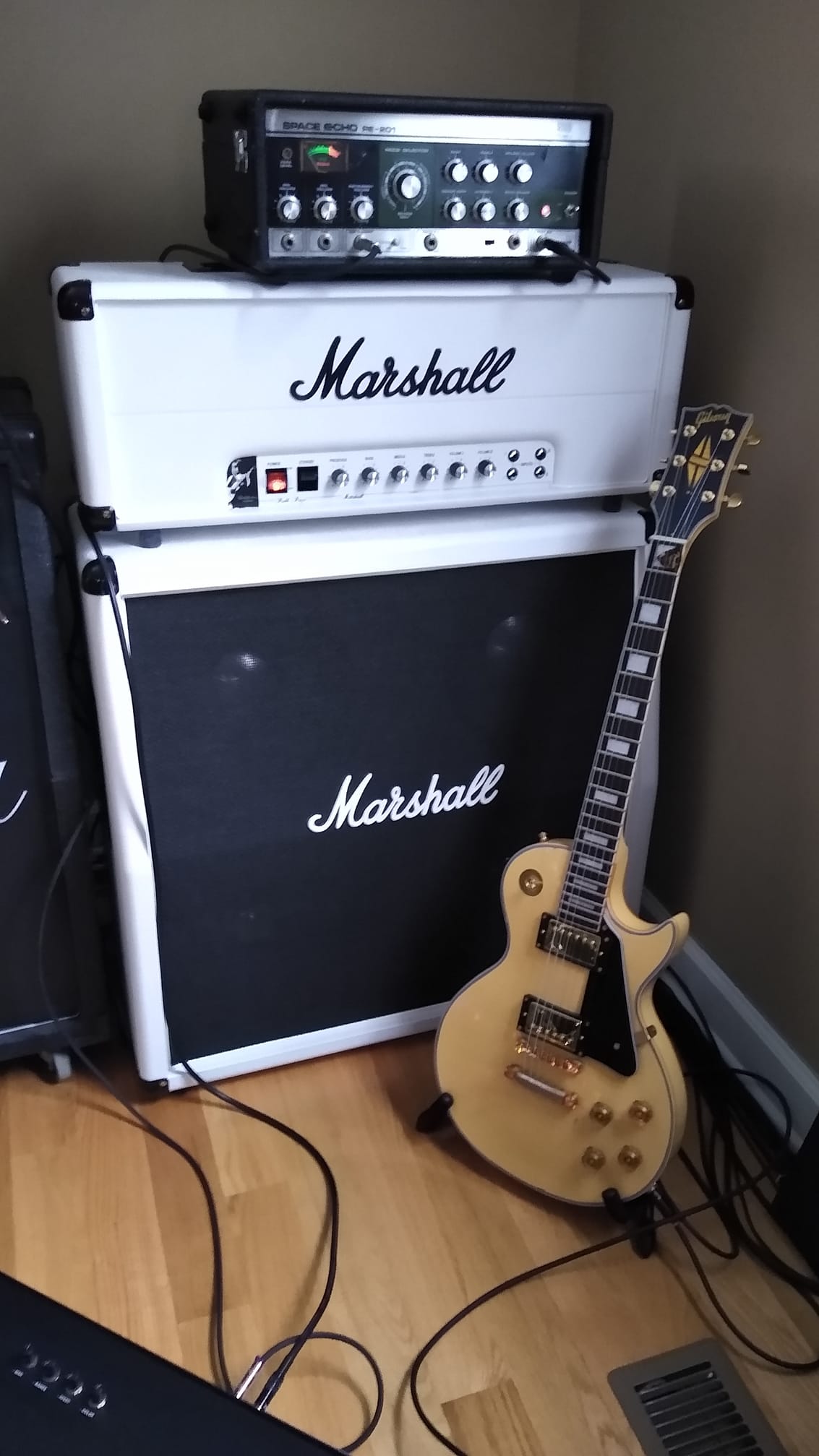

Yep! And that's why I now have EVERYTHING to complete his rig when the pedalboard is done!
I have the guitar (real 72-75 LPC) with the Super 74 pickups with Alnico III pickups. I have the 1959RR head. I have the 4x12 cabinets with a complete set of original late 70's Altec 417-8H Series II speakers! I have all of the era correct MXR pedals (1977-1980). I have the GHS strings. I have the correct Medium Fender pics. I have an era correct 1980 Space Echo!!!
This will be the CLOSEST Rhoads rig without having and playing the real deal and original...and that will never happen (anyone own it). It will never go for sale in our lifetime (unfortunately) and would go for millions and millions of dollars (again, unfortunately).
I have a sickness...but it's worth it and can't wait!!

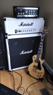

...just a couple updates...
1. Was not able to finish the pedalboard over the holidays due to:
i. After start assembling and wiring, had some questions in regard to the looper and question if it is now going to do what I want (it's technical). If not, I will use a custom one I came up with over the last couple of years! Works 100% (already validated) and will do what I need it to. I had about 10 board produced (only need
, but will have to come up with a housing to support it/everything or have new PCBs produced and fastened to the bottom of the board.
ii. Randy's indicator lights were 1/2" (12.7mm). I had these 1/4" ones installed and will work 100%, but once I say the board at RARHOF, I wanted to be more accurate. I had previously purchase some indicators, but they are 16mm and larger. I still wanted 12mm. I found some recently! They are in transit from Hong Kong, China and should land on Saturday! I can evaluate if they will work or not, but should. Likewise, the 1/4" only drew 2-3mA of current at voltage. The larger ones was more like 20mA, but at voltage I'm using 10mA, but still much more than 1/4" and I have 8 of them to trigger, so 80-160mA just switching bulbs on and off. From a design and engineering standpoint, just trying to make efficient.
All of the appropriate jacks were drilled and installed, so that is done. Just need to finalize indicators and looper method, install and wire everything up! As this year marks the 40th since Randy's death. I should have done much earlier, but can showcase on 03/19/2022 and with the entire rig and white amp! Soo looking forward to it.
It's been soo long.

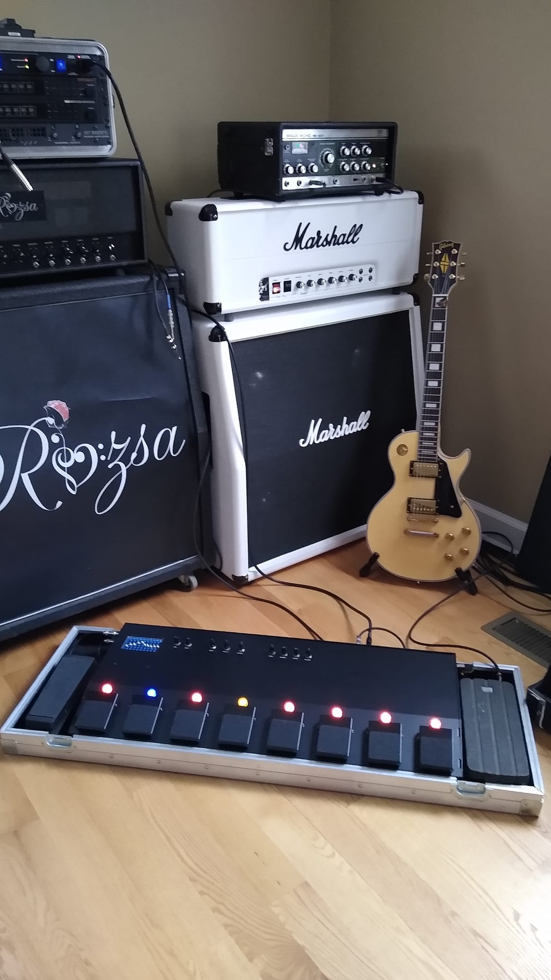

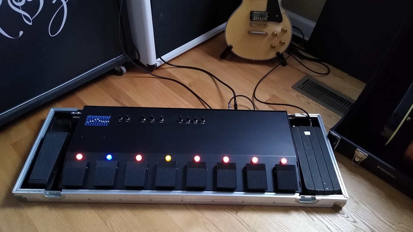

Today is a happy day and sad day....We lost Randy Rhoads (my favorite guitar player of all time) 40 years ago today (on my birthday), but rejoice and celebrate his life and contributions.
Today, I finished a clone of his original pedalboard custom made by Pete Holmes!
I started working on it 2 years and 4 months ago and had it almost done (custom roadcase, custom enclosure, all vintage era-correct pedals). The one thing that I have been kicking around is how to switch the FX, whether to be just true bypass on 3PDT switches, or something else.
It wasn't until a close friend communicated that Randy had a switcher/looper in the board. I at first said no....but when I started looking at the more in more detail, I noticed the footswitches are industrial momentary switches! Meaning, it absolutely could not be on latching 3PDT switches. Soo, I needed some sort of switching scheme and using either transistors correct for the era or something else. This is what took me soo long. I decided on utilizing latching relays and readily available transistor and a 555 IC timer, again readily available during the time in a flip-flop circuit and acting like a true bypass shunting the effect to ground when not in use and passing the signal thru!
After 40 years since Randy passed and almost 50 years since the board was built....I am unaware of ANYONE that has tried to clone it, none-the-less actually recreate it and a working unit!!! It is 1 of 1
clone and 1 of 2 similar to exist!!!
As today is as I said, my birthday and booked up, I will in the hopefully near future post actual videos/clips of the unit and rig in action! In the meantime....enjoy!
LONG LIFE RANDY RHOADS
