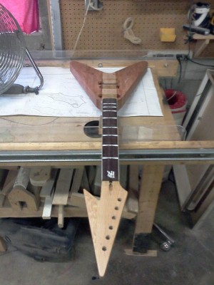

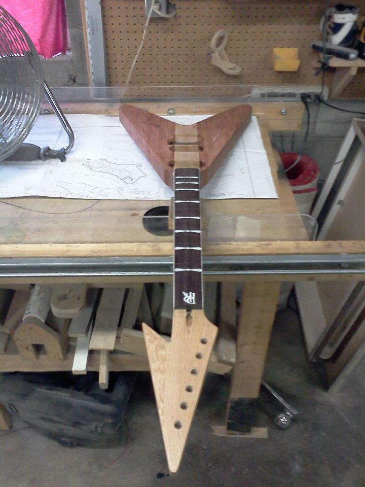

as some of you know here i am having a custom polka dot v being built and its almost done and im very happy with it so far the builder does everything my hand and has done a awsome job well its been primed and painted black and now getting ready to do the white dots he ordered a mask to do the dots not to sure what that is like a cover to paint the dots on the guitar i think and i know it cant be easy to do the dots and make them like origional guitar has anyone here ever painted polka dots on guitar or done a polka v if so how did you do the dots thanks
