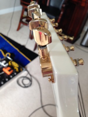

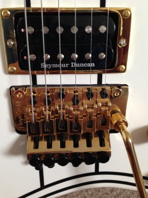

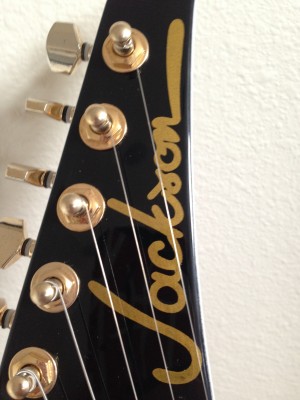

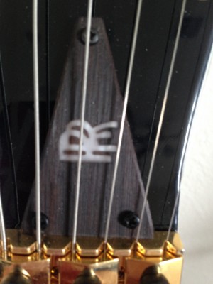

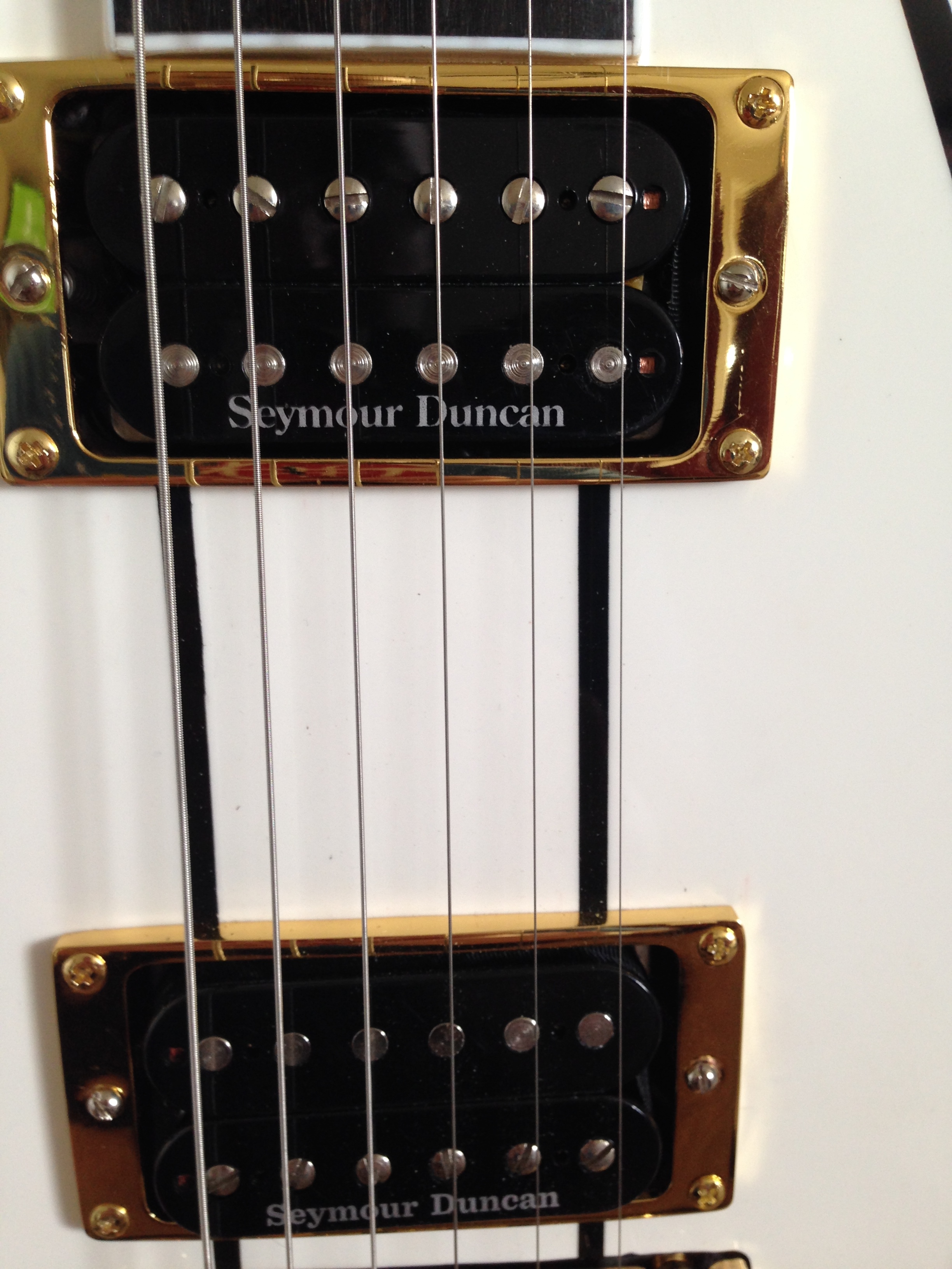

Some pics of the Concorde, stays in tune, great clean tone, fun to play, looks spectacular!...all for $1K

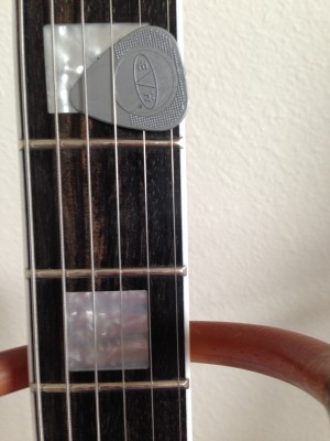

I don't know if you can tell but is your inlays MOP I cant tell on mine

sure seems like they are, what could they substitute it with if they aren't?

Post by Nick »
a Hard plastic

I think it's the real deal

You can tell the difference from plastic vs real mother of pearl as the MOP has sorta reflective surface. While plastic does not have that mirror type smoothness to it. One of the pictures looks like it might be the real deal. It is hard to say from the pictures alone. Most of the other pictures make it look like a cellulose plastic was used.
Reflective is not really the right word. But it is a very smooth surface with no pores and the MOP has certain properties to it that plastic doesn't. If it doesn't look fake it isn't. That is the best rule of thumb.

I just got my hands on a brass NOS bridge for my Chinese Concorde.
I feel like I remember Dino had a similar issue with his. But the block doesn't fit correctly, and I don't think the screw holes are going to match up too well either. I was wondering if anyone else ran into this, and if you had any tips about going about it? I know I'll have to take a router to it, but I'd definitely would love some tips. I messaged Dino the other day, but it seems he hasn't visited the forums in quite some time...kinda why I posted this here as well.
"I don't wanna stop here..." -Randy Rhoads
Nick
Posts: 141
Location: At home
Re: Progress on the Concorde!!!
Post by Nick »
Robthewild1 wrote:I just got my hands on a brass NOS bridge for my Chinese Concorde.
This will happen on any Chinese guitar because they are using their own metric system compaired to the Americans, like dingo you will have to rout a bigger trem block cavity, I would fill in the term screw holes with putty and re drill them. That the only way to make things work.

Sorry it's taken so long, but I just wanted to say that Dino sold his Concorde to me last year.
I can confirm that the bridge is off from the holes (like Nick said). Mine only has the 2 outside screws in. Funny enough, that's how Randy had his if memory serves. (Though, that was for a different reason)
