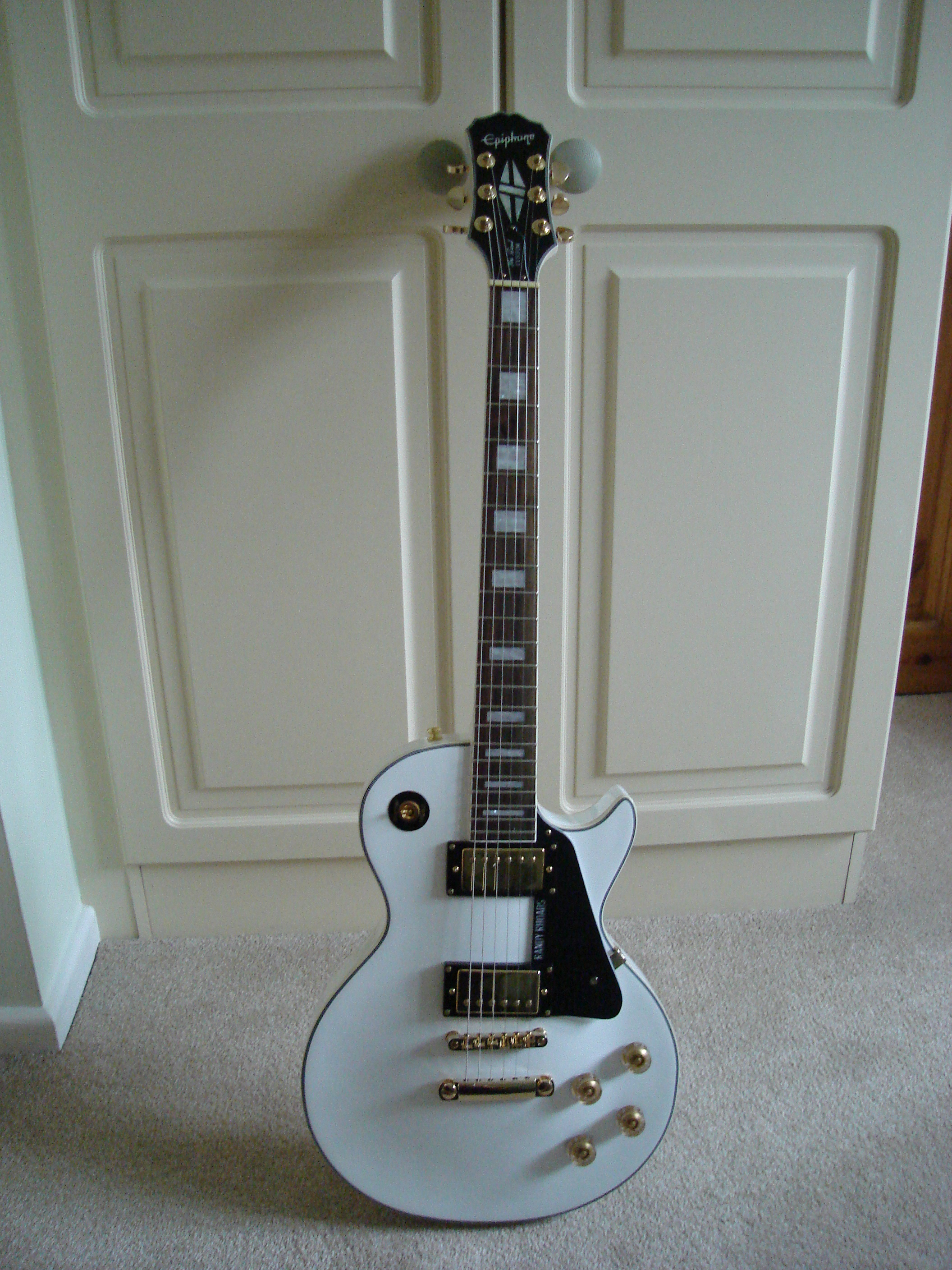

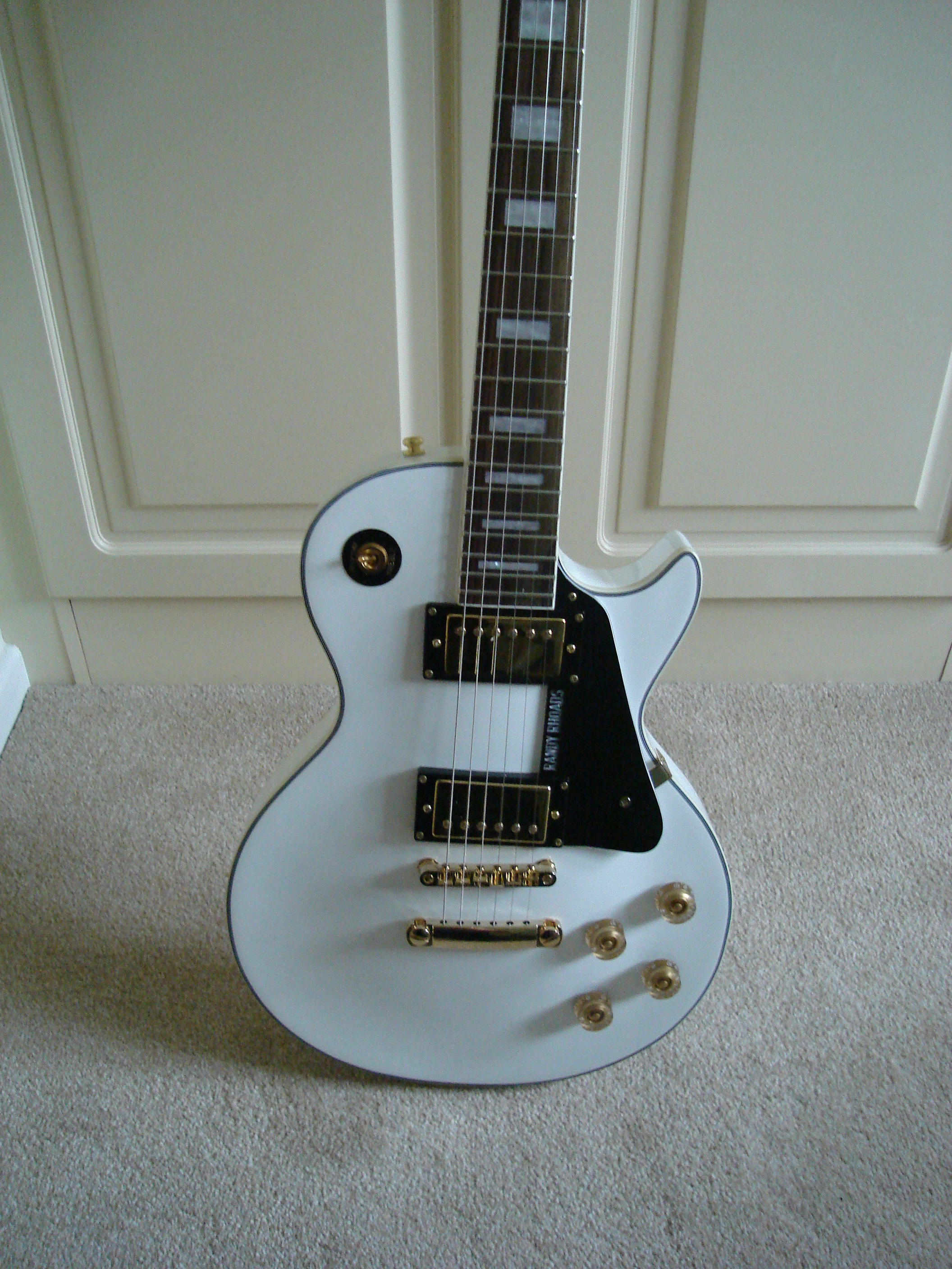

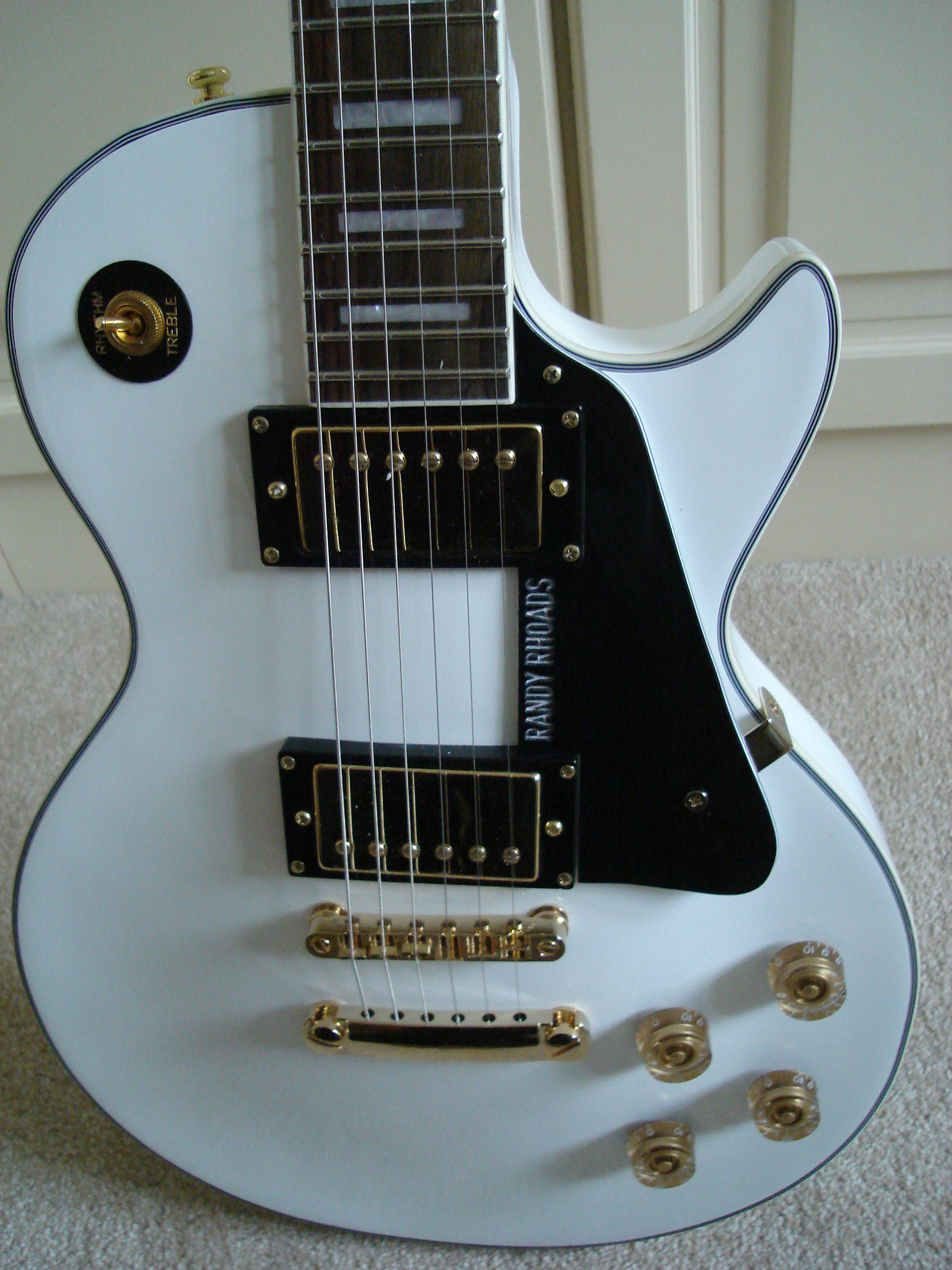

Here's a work in progress of my Les Paul Custom Epi Randy tribute.
Just waiting for some new pick ups then I can have the electrics upgraded to CTS pots/vintage wiring etc.
Hope you like the pics, tell me what else I could do to it to further improve!
Re: NEW EPIPHONE LES PAUL RANDY TRIBUTE PROJECT!
...Also!  I know that Poly finishes are nigh on impossible to age/yellow - but if anyone has had ANY luck with one like this let me know!  I think the option I have to yellow the finish is a refinish....which would cost what the guitar cost!
Looks great!! I wonder if you could just spray some tint coats over top, along with a few protective clear coats, rather than stripping down and refinishing? You'd still have to wet sand and polish after though.
Could always put a cigarette burn in between the knobs, and well as take a scraper to the back too, like in the pic DMRX's posted:
[quote="Whipper"]Looks great!! I wonder if you could just spray some tint coats over top, along with a few protective clear coats, rather than stripping down and refinishing? You'd still have to wet sand and polish after though.
Cheers Ric - I'm not so bothered about the relicing as much as the correct tint/colour. What would you recommend to add the yellowed look?
No worries, I was only joking about the relicing. I know I wouldn't have the heart to put a scratch on that beauty!
Tinting is done by coloring clear lacquer with a dye, such as alcohol-soluble aniline dye. A small amount of the 'vintage amber' of these stains might do the trick:
http://www.stewmac.com/shop/Finishing_s ... tains.html
The yellow would be too yellow, unless used lightly and mixed with a tiny amount of brown and/or red I would imagine. I'd consult with someone experienced with tinting and spraying lacquer before trying it on your guitar though, or at least try experimenting on pieces of white plastic.

I too would like to see pics...I have a 2009 epi les paul cutsom. It has every little thing randy had on his. the gold speed knobs, knob indicators, brass switch tip and ring, blank truss rod cover, shaller strap locks, and shaller M6 tuners, all i need is it to turn yellow somehow, and RANDY RHOADS engraved on the pickguard (gone to a few different trophy shops, all of them saying they cant do it.)
									12.6.56-3.19.82
The trophy shop I used had to do it with a laser I believe. They wouldnt do it on the store equipment for fear of snapping the plastic. Cost about £10AeolianMad wrote:I too would like to see pics...I have a 2009 epi les paul cutsom. It has every little thing randy had on his. the gold speed knobs, knob indicators, brass switch tip and ring, blank truss rod cover, shaller strap locks, and shaller M6 tuners, all i need is it to turn yellow somehow, and RANDY RHOADS engraved on the pickguard (gone to a few different trophy shops, all of them saying they cant do it.)
